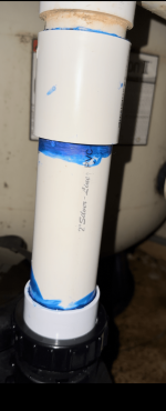

I installed the pool pump today and have a slow leak which lead to a drop every 5 seconds at this junction and wanted to know if that is a concern and if I need to redo the plumbing for that whole area? You can see the drop as well in the photo. Would applying pvc glue on outside help?
Is that suction or pressure? Glue might help on suction but won't on pressure.

Yes, that is the pressure part of the system. DavidArmenB says he has been successful using multiple layers of PVC cement. No problem. Might work for you, too.
Great, I will try multiple layers as well and give it a go and if not just redo it.
