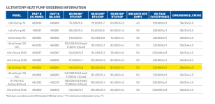

The UltraTemp 110 has the highest COP at 6.1.

Note that as temperatures drop all the HP's have the same efficiency COP at 50F...
