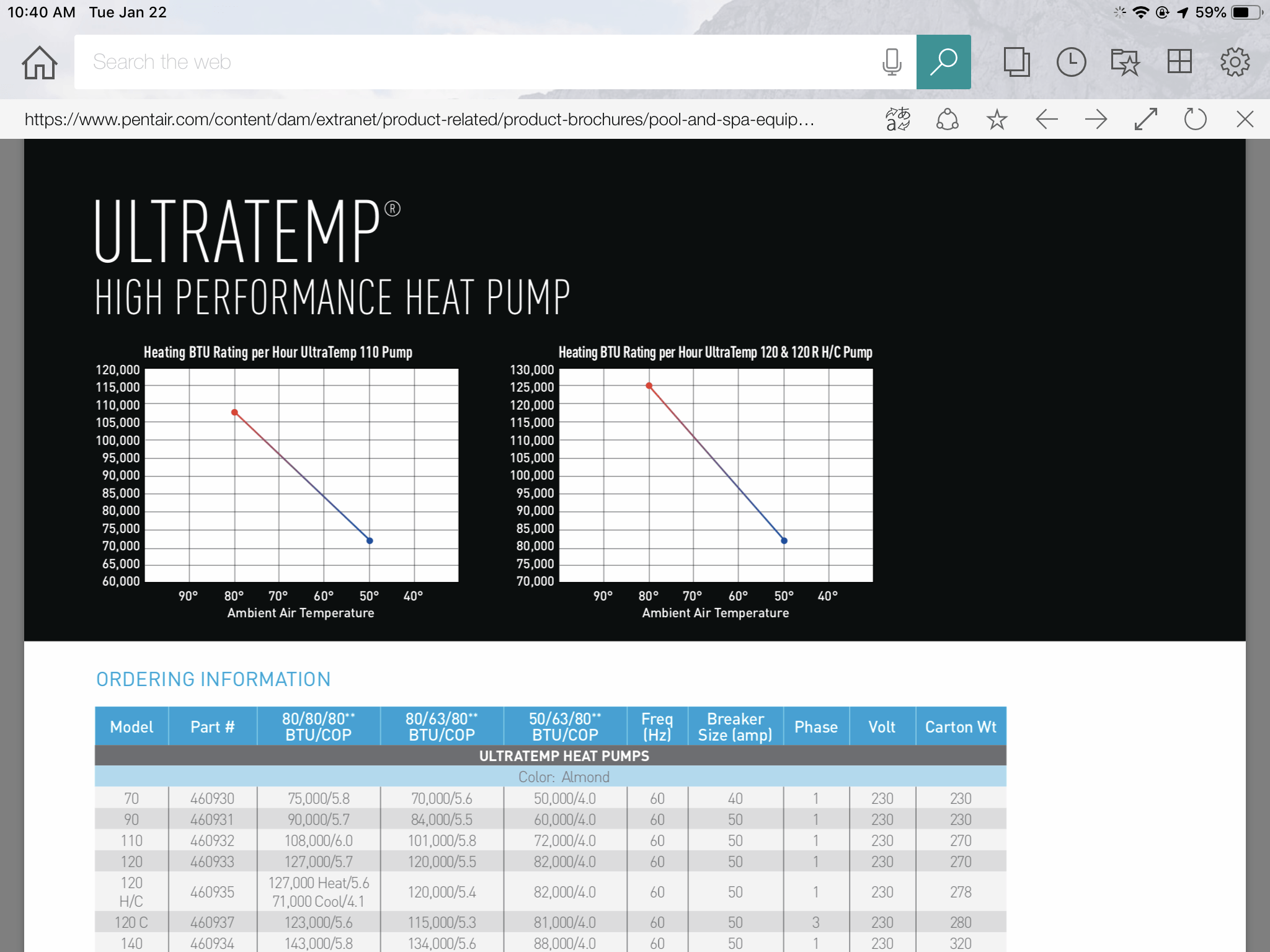

The chart below shows that when air temp is between 55-60F your HP puts out about 90,000 BTUs.
90,000 BTUs will heat your 36,000 gallon pool less then 1/3 degree per hour.
Even when the air temp is 80F your 120,000 BTUs will heat your pool less then 1/2 degree per hour.
