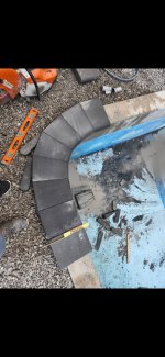

I'm having a real issue with cutting the corners of these coping stones.
I'm laying them out around the corner with the appropriate over hang. What ever the space is on the back, I'm dividing that by 2 and taking that off the front. Because of the radius being pretty tight, in ending up with the bull nose 3 inch wide and the back is 12" wide. It's not working out to well.
Should I be cutting the stones in half first?
Cardboard! Get some big cardboard and use that to make a template. It might take a couple/few tries to get it just like you want. THEN use paper in the size & shape of the coping pieces and play with cutting them and overlapping them until you find just how you want them to be. It will take some effort and time to come up with just the right way to make it happen.
I am going to do some looking to see how other pools with the curved edges and straight coping did theirs.
