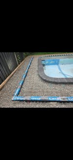

Another question, I have a price of aluminum plate over the skimmer to support the coping stones. Is there some type of adhesive to bond the mortar to the aluminum?
I would use some type of construction adhesive instead of mortar on that assuming you don't need any height buildup of the stone.
