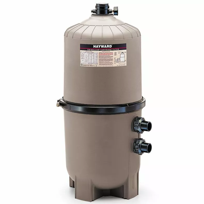

I started a post a couple of weeks ago asking for advice on a new filter, I currently have a DE filter and I’ve decided to make the switch to a cartridge filter. I am not sure which size to get, but I’m leaning towards a 325 st ft Hayward (or 425) I really want to replace my pump as well, I would like to get an energy efficient variable speed pump, if I can find something suitable that is currently available. I normally have my pool open by the third week in June, but I have a lot going on this year and then I had 2 does and 3 brand new fawns take up residence in my yard for a few weeks (the fawns had a blast splashing around on the pool cover). I am dreading taking the cover off, but i think I need to get it open. I did a lot of research on which capacity pumps and filters would work together and frankly, I’m a little confused. My pool is pretty small (6,000 gallons, in ground) and I know it doesn’t hurt to go bigger on the filter, I just don’t want to oversize the pump if I can avoid it. Also, i know the pipe used in the plumbing is 1.5” ( it’s an old pool) and I’m not sure that everything I’m looking at is compatible with that. I would appreciate any advice.
I am looking at this filter :
