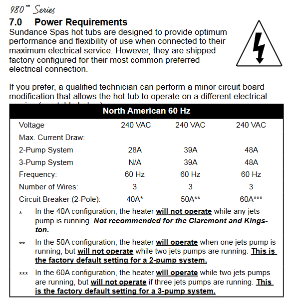

Let's look at the power requirements for Sundance Spas that I am familiar with...
While the spec say it can run with 40 amps, 50 amps or 60 amps you will see that if configured for 40 amp service the heater and the pumps cannot run at the same time. You need 50 or 60 amp service to be able to use the maximum features simultaneously.
