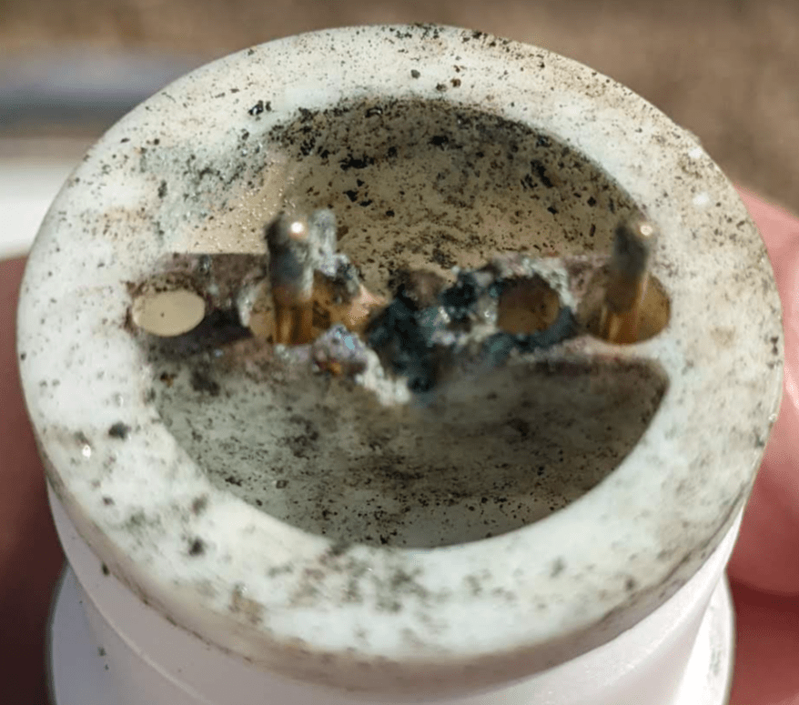

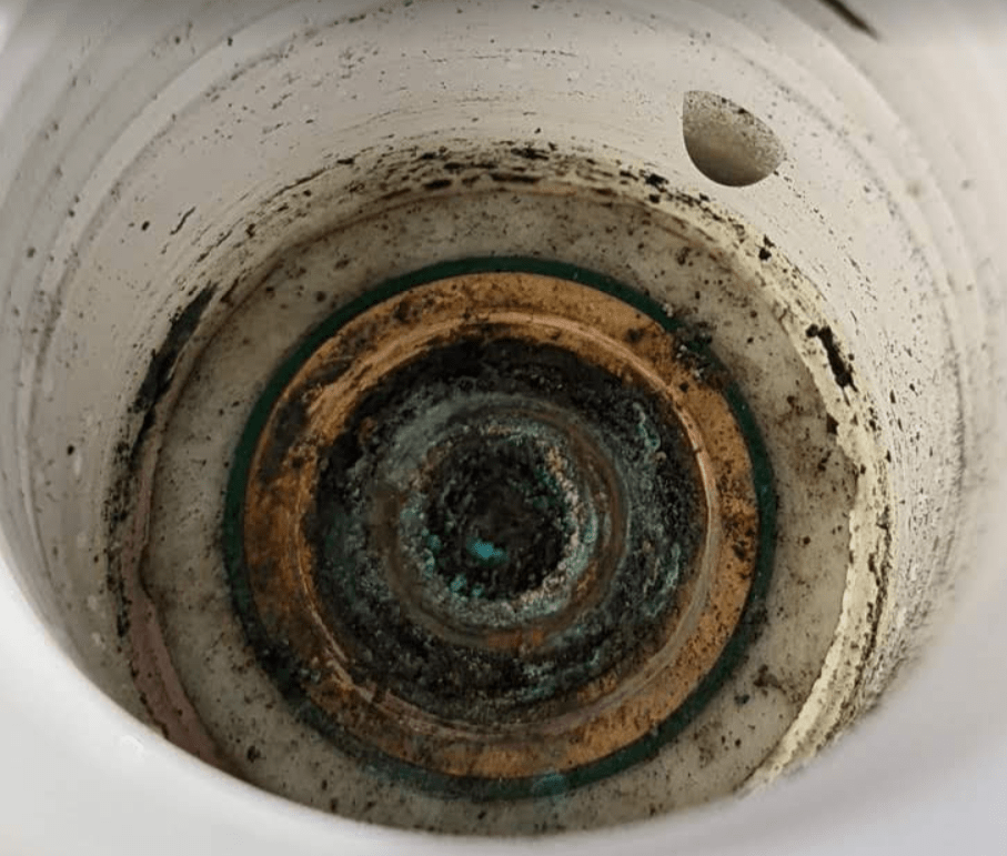

I bought mine Late june 2021.. It worked fine till I took it out in Oct 21... I put it in the pool 3 weeks ago and it lasted about a day... When I took the swivel apart the 2 o rings were not lubed and had water in it.. One of the 3 metal pins were melted down from power arcing across... I think this also messed up one of the boards in the power supply or the robot as when I repaired the cable it would start and clean the pool but when it started you could not connect to the robot anymore till the end of the 2 hour cleaning or you pressed the stop button..
