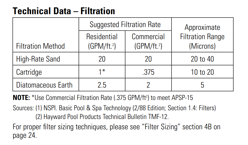

Sorry you haven't gotten an answer to your question. I get it. You don't believe you have an algae problem, you want the benefit of the DE filter for clarity, but don't want to clean it often. You think having a sand filter first, followed by a DE filter would allow you to filter most stuff and backwash, while the DE filter would "polish" the water.
One option:
Not sure if it is advisable to put two filters in series, may be a bit of pressure...let's ask the experts...
@ajw22 @JamesW @mas985 @1poolman1
Reactions: ksguy
Maybe get a TR-140 sand filter and then a CCP520 cartridge filter and then a FNS Plus DE 60 filter.
This way, you filter successively finer dirt.
