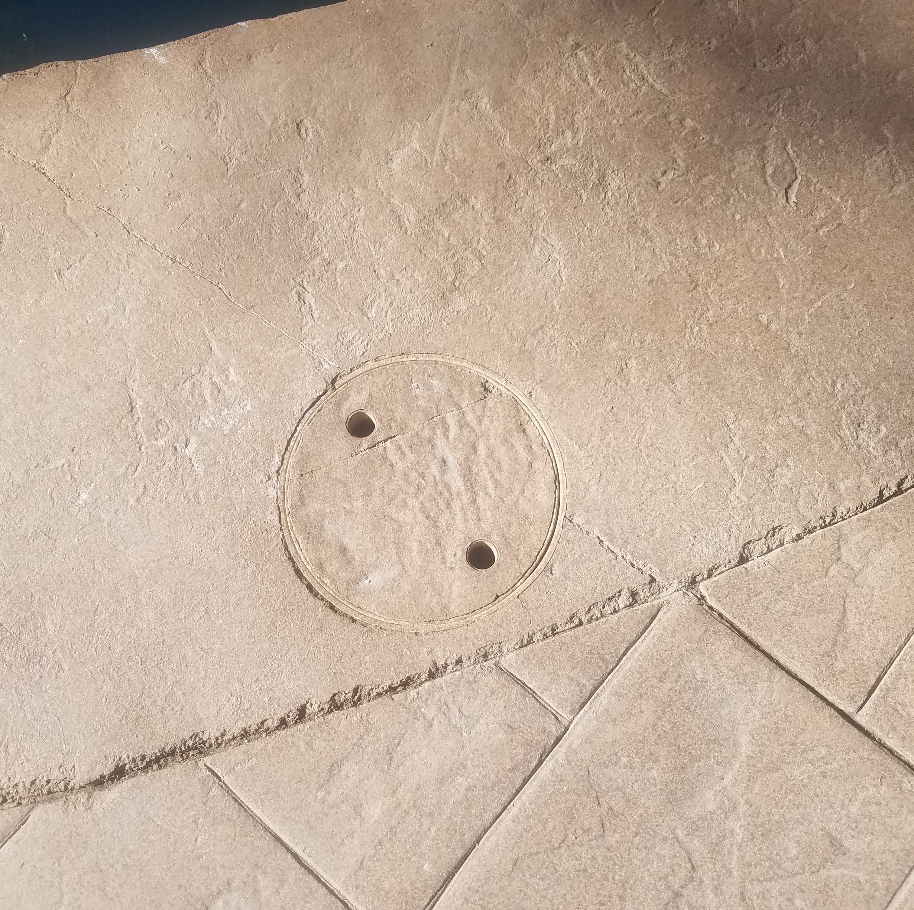

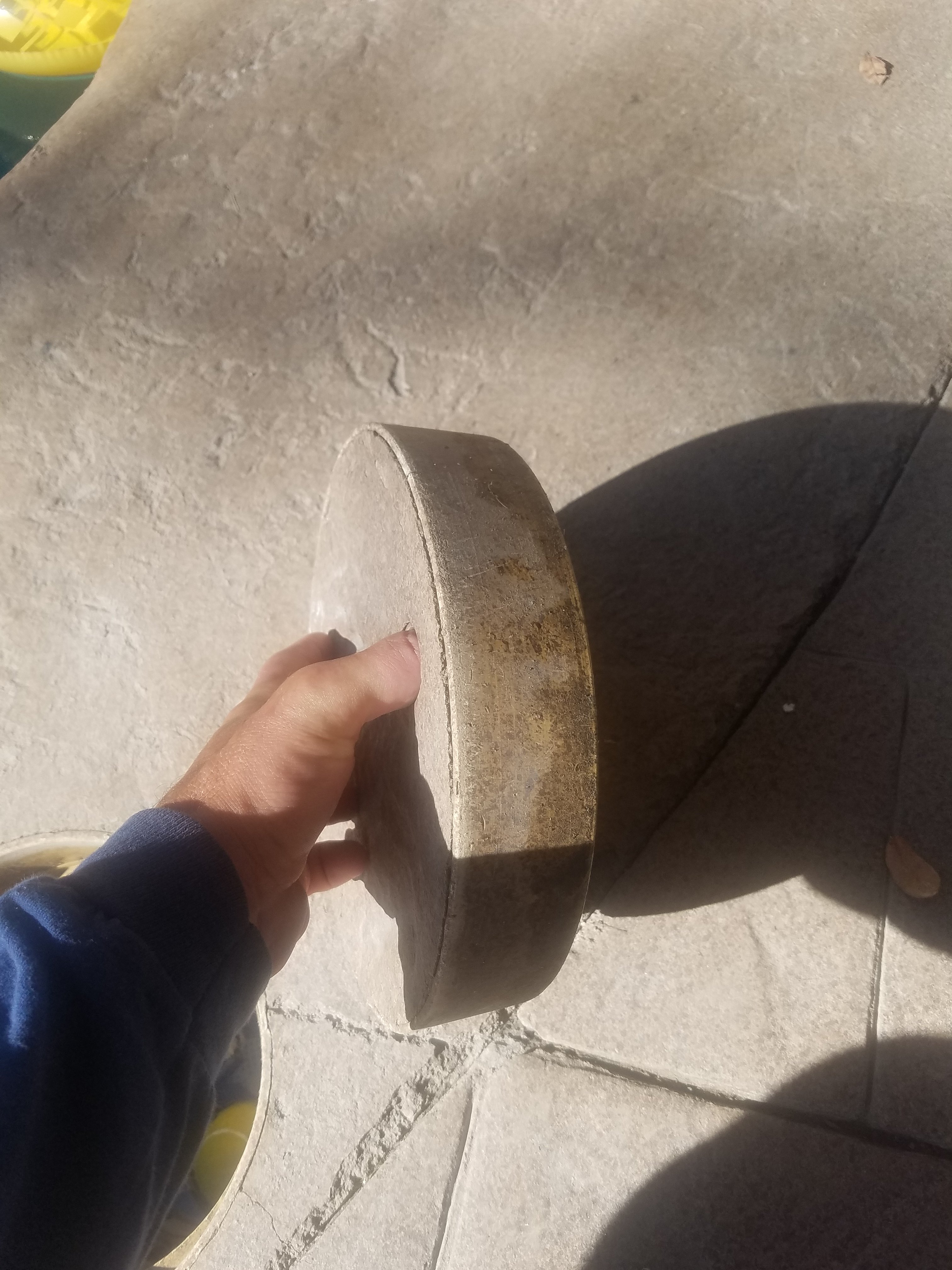

Hi Stoop
I have just had one installed and I'm very happy with it so far. Although I have a Travetine paver inserted into mine (couldn't match the colour of the existing pavers). it's the same as a concrete poured one. Yes they are heavier but it stops them been lifted by kids and and a Tbar type tool is requires to lift it which complies with AU pool safety standard.
The lid fits into an inlay frame which stops the deck getting chipped when removing and inserting the lid. Before this I just had a cut paver as a lid which cracked and chipped over time. Picture below with removing tool inserted.
I hope this helps!
