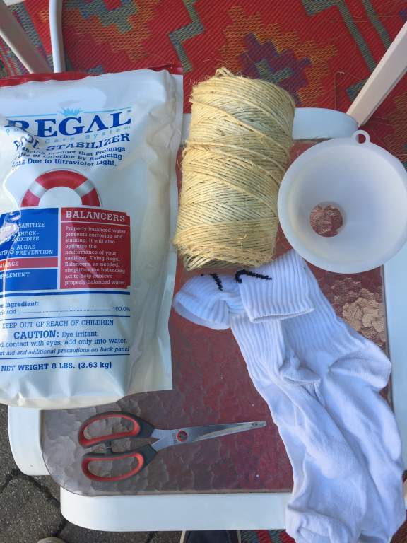

Below is a pic of my CYA addition kit. In the upper right is the funnel I put into the top of the sock and then pour the stabilizer into. It is dual use and its day job is adding salt to my Miele Dishwasher.
