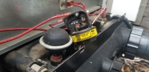

Started working the inside and would like some advice on whether this is right or not. Please see that the water pressure switch is just kind of hanging and not attached to anything. The bottom piece just falls out (there's nothing holding it together other than the strength of the magnet holding the two pieces together, but it doesn't take much to pull them apart. Seems like there is something missing. . Any thoughts?
Thanks.

Ok, confirmed that it's the pressure switch. I can close the switch and the LO goes to bo, but as you can see in the picture, the diaphragm from the pressure switch is bubbled up good when the pump is running. Is this a normal failure of the switch - with the two half's separating or do I need to investigate further?
Thank you so much for the help! Got everything running. This is the second issue you guys have helped me fix and I can't thank you enough. I have several more coming as I have to fix the many issues the pool builder left us with.
