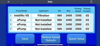

To control each pump, the RS485 cable will need to be run to a RED connector. You should have 2 RED connectors on the top of your board. You can connect 2 devices to each RED connector. So 2 pumps to one and 1 pump + the Antenna to the other. If you have something else that needs a RS485 connection then you will need to purchase the RED connector extension board.
When you go into the app to set up each pump. Set the filtration pump first as Pump 1 and select Pentair IntelliFlo and you must select VS mode (RPM). The Jandy system does not recognize the VF mode of the pump. (GPM).
Come back with more questions. See photos below.

Follow up to Q2. For the 2nd pump the application will be Auxiliary. Then when you go to the next screen to set the speeds, you will have a column to select the auxiliary so the system knows what functions to perform.
Same with Pump #3. Set it to Auxiliary but on next screen the auxiliary will be different from pump #2.

Yes. I was only addressing how to select the pump in the automation. denote each pump as 1 (default), 2 and 3.

Yes. The screen after this will allow you to set speeds and should select the proper HP auxiliary for control.

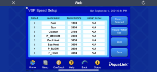

Each Pump will have its own address and as you set it up you will be able to set up various speeds for it.
I do not have multiple VS pumps but my understanding is that teh screen after the pump selection, you will then go to the speed set up and there be able to establsih various labels. Those labels will then show in the schedule so you can set times and when that schedule becaomes active that corresponding speed will be active.
Notice the top right box - Pump 1. This should change to Pump 2, Pump 3 as you set speeds and labels for each.
You may need to set labels in a different section.
See how the Labels in the speed set up are then able to be selected in the schedule screen. FYI - Filter Pump & POOL are one and the same for the main filtration pump.

It has been a while since I set up the labels. But you may need to go to these screens to set up the labels For the equipment connected to each of the HP Relay Auxiliaries
The Aux1, 2, 3 are the corresponding HP Relay Auxiliaries that your additional pumps are connected to. The Main filter pump is always connected to the Filter Pump Relay
Note - the Speed Labels have some preset names but you can change them in the Speed Setup screen. For your Filter Pump it is best to use the preset up labels such as POOL, SPA, CLEANER, etc. Then the other speeds you can create new names as I did.
