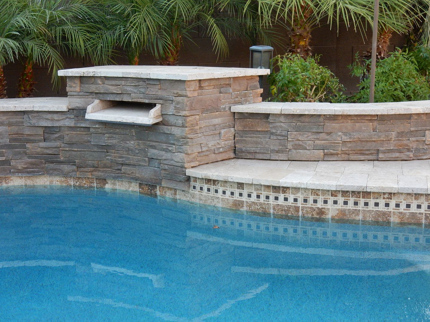

pretty talented design on the wiers! I am familiar with weirs, clarifiers at waste treatment plants used them for even flow around the basin. so I imagined you had to make sure the weir was level so that the flow could go out evenly wide?
AP, thx again. My brother-in-law’s firm specializes in water treatment plants…weirs must be common in that industy. Yes, the weir needs to be near perfectly level…but before that, installation of the waterfall ledge itself is extremely critical for water to flow off the falls cleanly. This is what I did (for those who might attempt a similar task):
I put four “globs” of mortar under the four corners of the ledge before I set the ledge carefully on top within the waterfall cavity. Obviously the back “globs” were bigger because the ledge needed to tilt downward towards the front so that water flows off of it. Next you lightly tap the ledge above the globs (more at the front rather than the back) until you get the downward angle that you desire. Use a level to make sure the slope is consistent on both sides of the waterfall. In addition, double check the horizontal levelness of the ledge by checking a few locations from side to side (at the back and the front for instance). This makes it easy to make the “weir” level.
If you screw up in the process (as I did a couple times by tamping too much on one corner), lift off the ledge and put down some additional globs and start over. After the mortar globs dried…I sprayed foam spray under each newly installed waterfall ledge to give it additional support and adhesion.

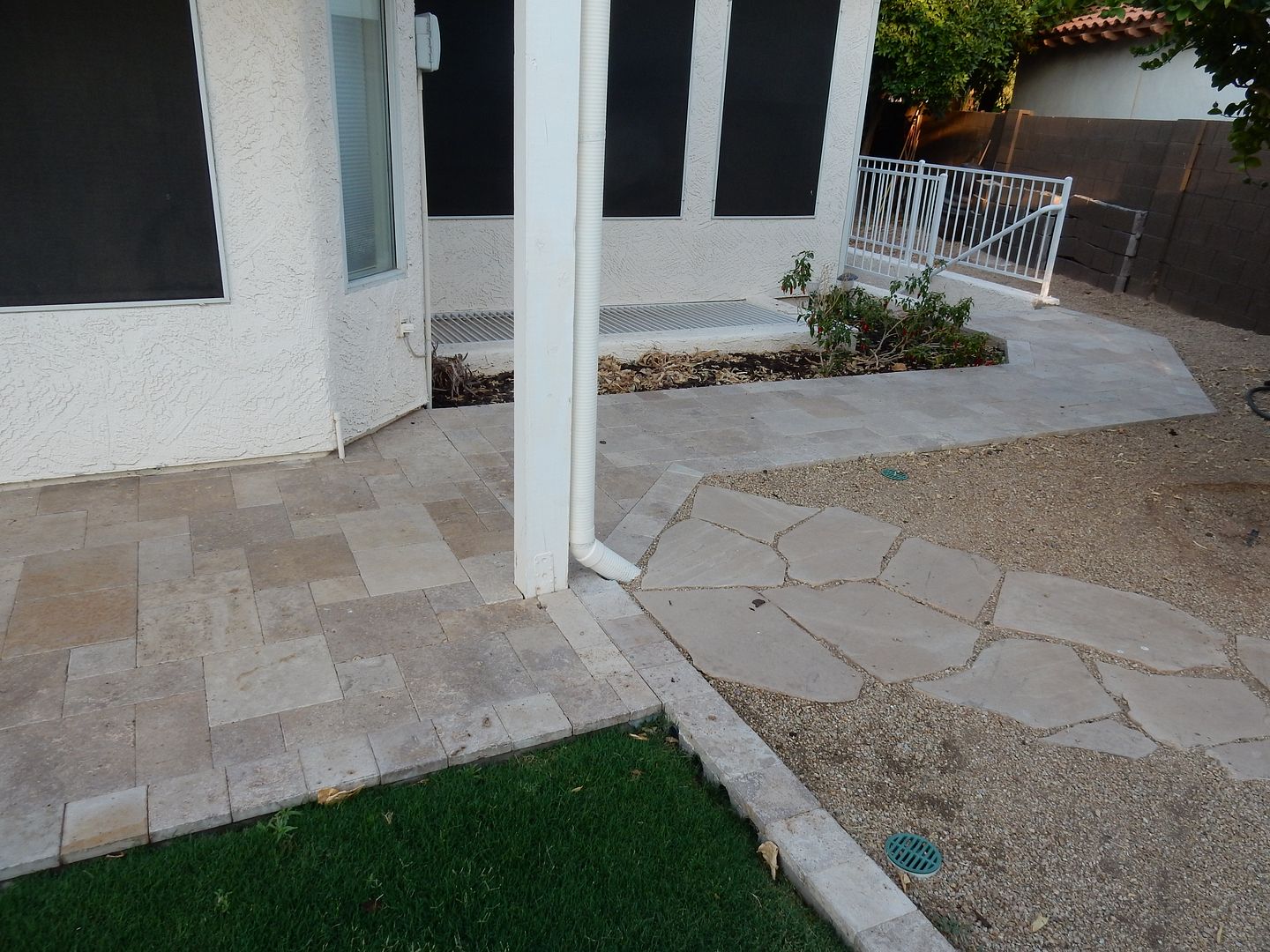

These are recent pictures…two years after we “finished” the project. Here is where it all started at the top of the basement stairwell.
The sidewalk to the stairs, notice the new travertine border on the bottom right side that replaced the previous red brick border between grass and rock area.

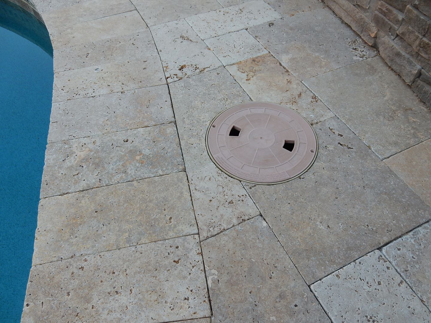

Finally finished the water leveler and the skimmer (about 3/4 day’s worth of careful work for me)
The border between the first phase of the project (patio) and the 2nd phase (pool deck).

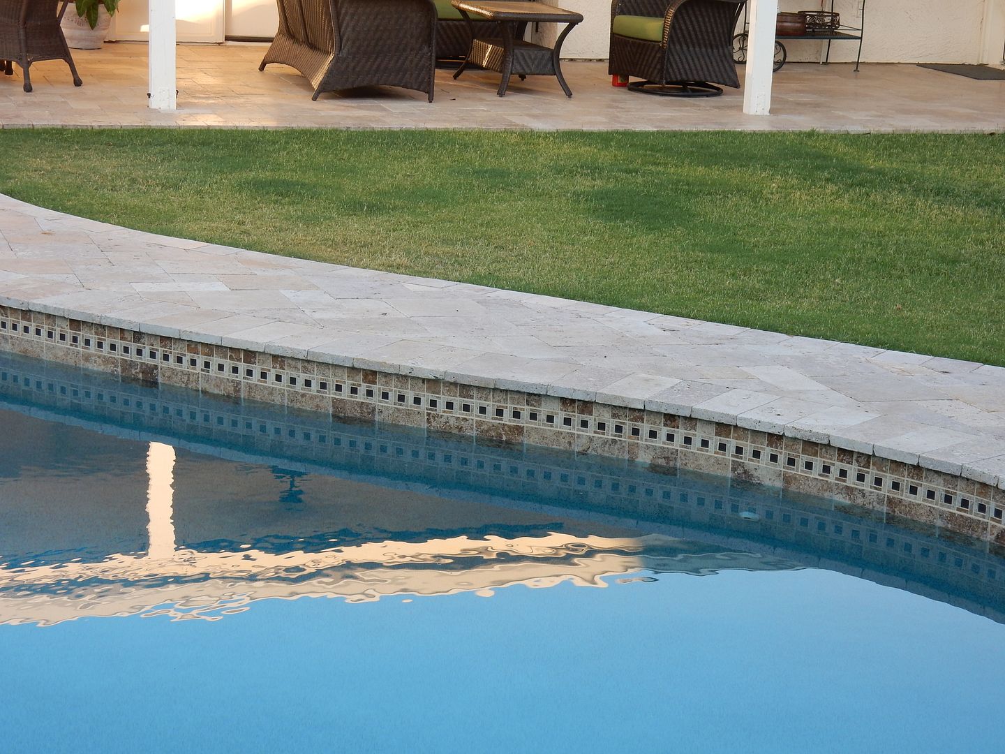

Decorative Tile view

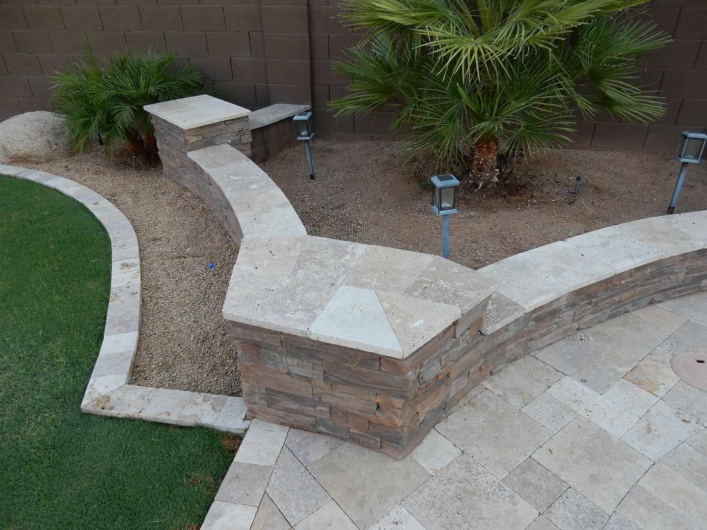

Right side waterfall

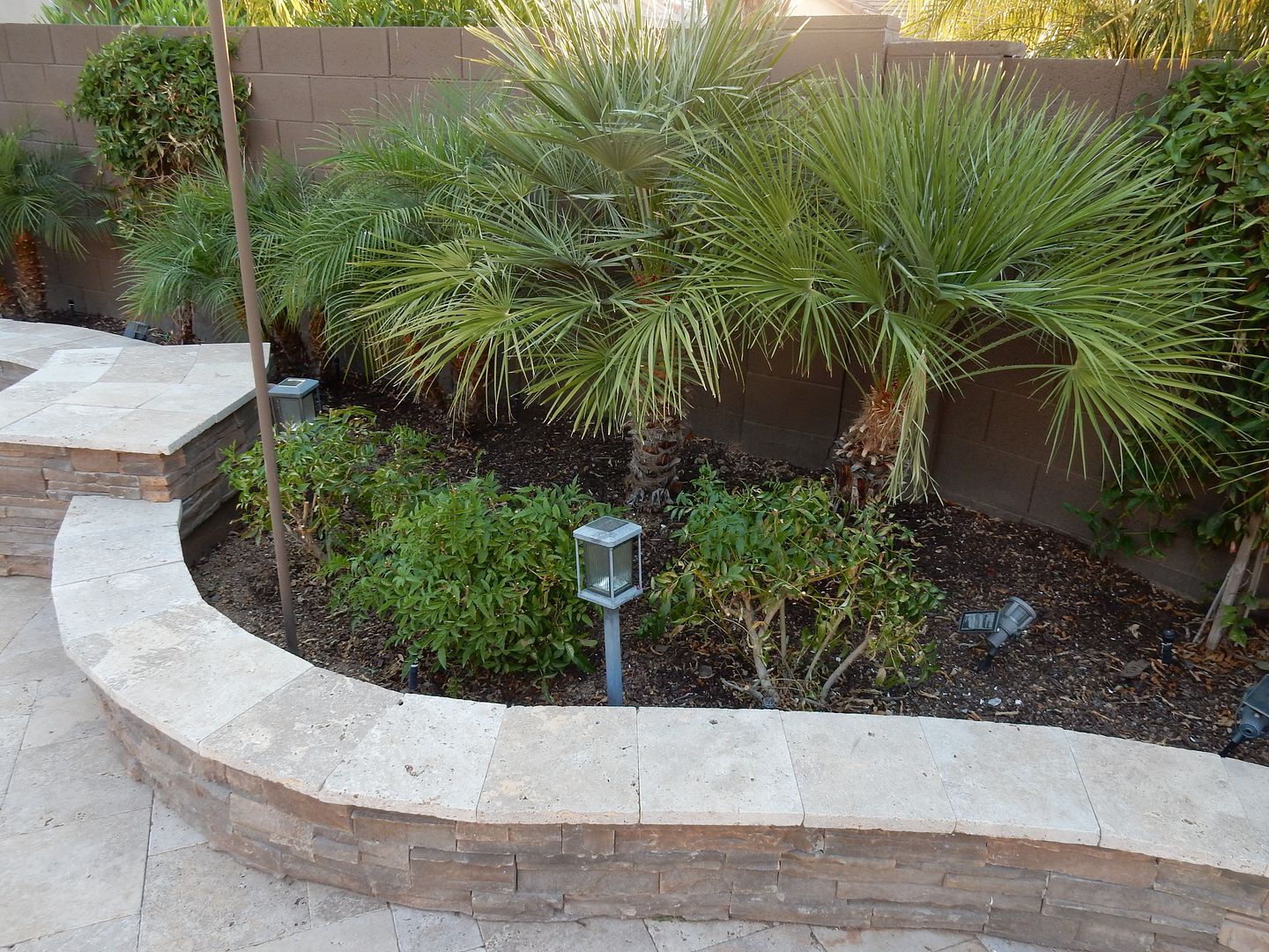

Trapezoidal planter area
Other side, low wall planting area

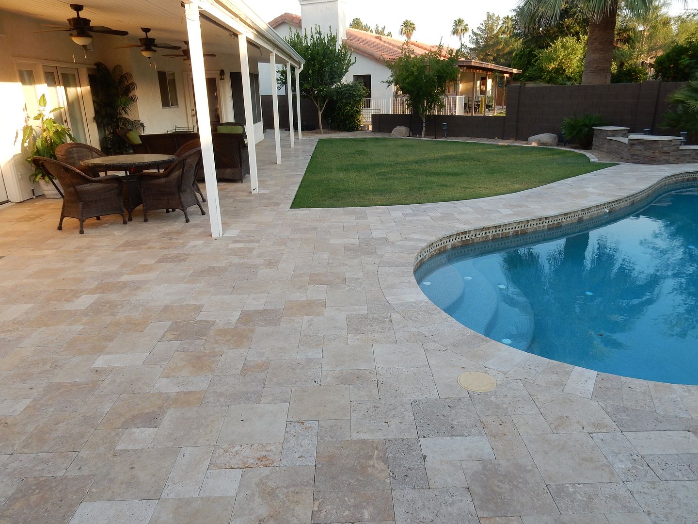

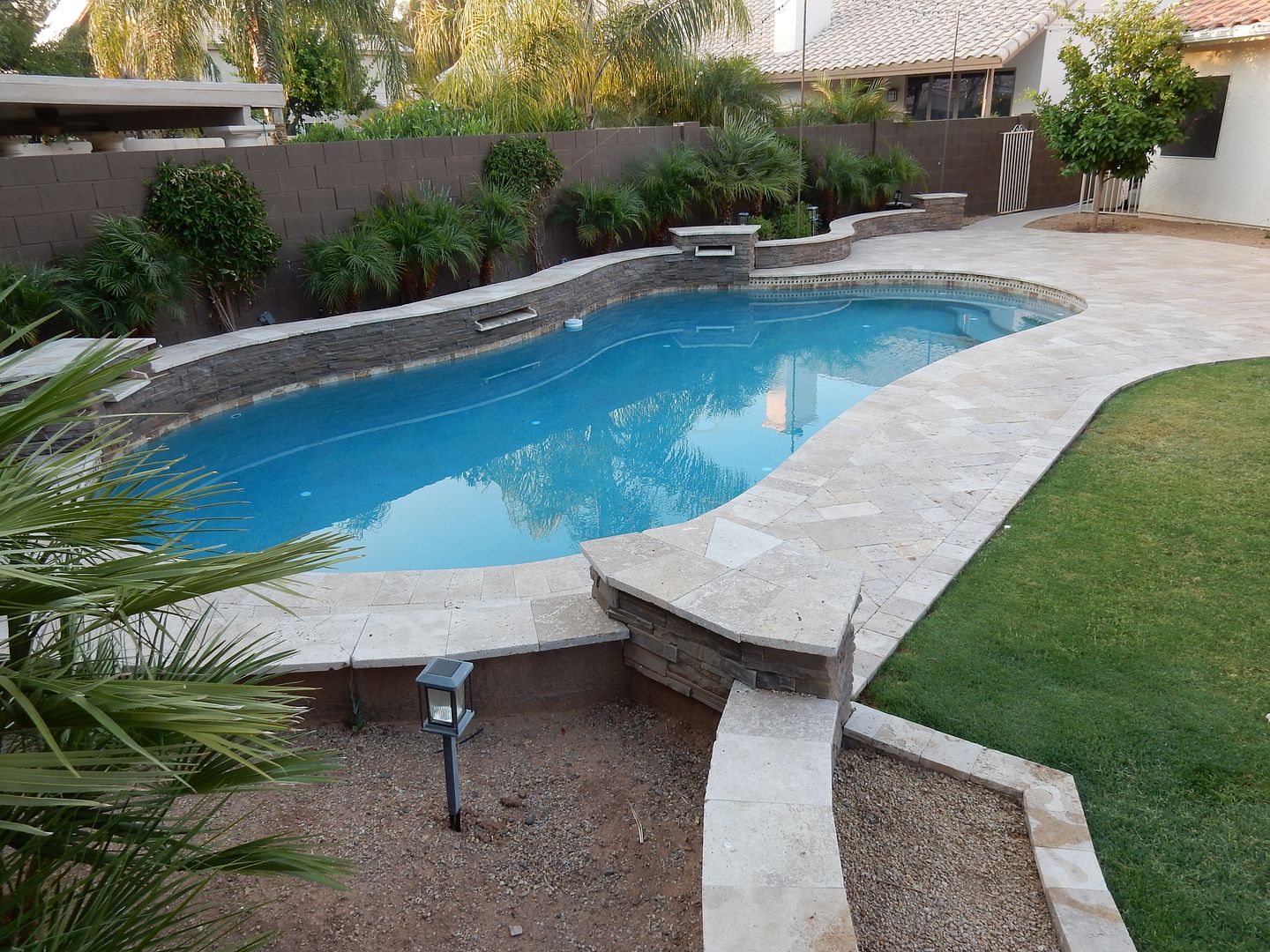

View from the back of the pool
Another view from the back of the pool
