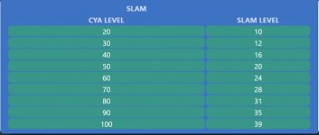

Based on the chart I need FC level of 16 for SLAM. Pool Math told me 472 oz so I put in 4 gallons of bleach. I waited an hour and tried another test strip. Still reads nothing on the chlorine tab.
I'm assuming it's an issue with test strips at this point. Either not reading FC correctly or CYA is way off so my SLAM value is too low.
I've got updates. I went to Leslie's and had a water sample tested. FC was 0.4 so still really low. CYA is 61 so my SLAM FC is 24 not 16. Also the TA is only at 74 so I have to get that up. Finally it showed the phosphates were high but the stuff that the guy at Leslie showed me was really expensive so I'll leave that for the owner to deal with.
