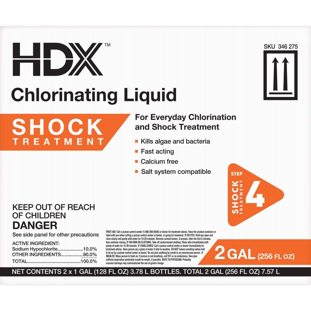

This is what my local Home Depot carries for 10% bleach (aka Chlorinating Liquid):
If your HD has it, it is most likely in the gardening section, possibly outside. Look for the latest date code on the box to get the freshest ones. While I was SLAMing recently I bought 6 or 8 boxes at a time, for a total of about 32 gallons over a 5 day SLAM on my 26k gallon pool. The amount you will use depends on the volume of your pool and the condition of the water.
And TFP recommends against using any algaecides or clarifiers under normal circumstances. Just stick with straight bleach.
