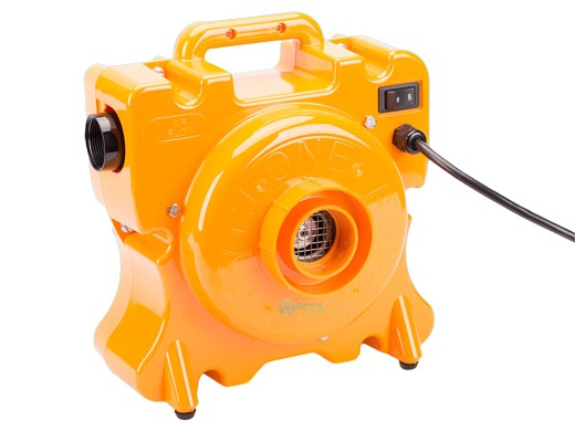

Compare your 4.3 CFM air compressor with the Cyclone Blowers 140 CFM. You need air volume (CFM) to blow out water lines, not pressure (PSI).

Oh! So I really don’t think a 4.3 CFM air compressor will work then. I have a main drain… two in the pool. And my pool is 6ft at deep end. What should I do? Ugh…

A cyclone will work even if you have a medium air leak.

I would suggest trying it with the rental and see how it goes. I don’t think it will work well because those style compressors are not designed for continuous flow. The flow/pressure specs only apply when the unit is used intermittently such as with a nailing gun or an air wrench. Those types of tools only require compressed air for a few seconds. When blowing out a line, you need a continuous flow of low pressure air to not only move the water but also to “dry out” the line. That requires a blower, not a compressor. If you were to leave a compressor running constantly to supply air flow, you’ll burn out the compressor motor.

Your choice if you want to get the cyclone now or try the compressor route. None of us want to spend $300 on the cyclone but that’s less than 2 closings from the PB if you do. :)
