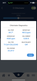

I noticed the SWG was showing 0.00 for cell current for multiple days so I tested salt in the pool the following day.

I have attached images of SWG diagnostics.

The Hayward system shuts down the SWG when high salt causes the amps to go above 8 or 10.
You need to get the salt level down around 3000-3200ppm. That requires about a 25% draining from your level. Read Draining - Further Reading about the No Drain Water Exchange.
