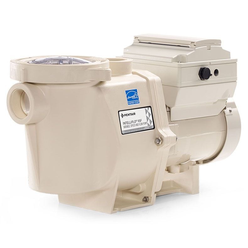

Pump would be this pump: (I am having a hard time finding the standard VS in stock. It also seems to be more expensive)
S,
The VSF can be set up to run as a VS pump or a VF pump or both.
95% of pool owners do not need the VF function. I suggest that you initial set it up as a VS pump and run it for a year. After the year is up, I'll bet you won't find any reason to use the VF option.

S,
Jim R.
same as below for some reason i did not see the replies to the thread and I edited my post.
The only reason I was leaning towards VSF is that it is more readily available and actually seems cheaper.

Thank you guys for your help. I think I am going to go with Pentair cartridge C&C 520 and the Pentair 3HP VSF
