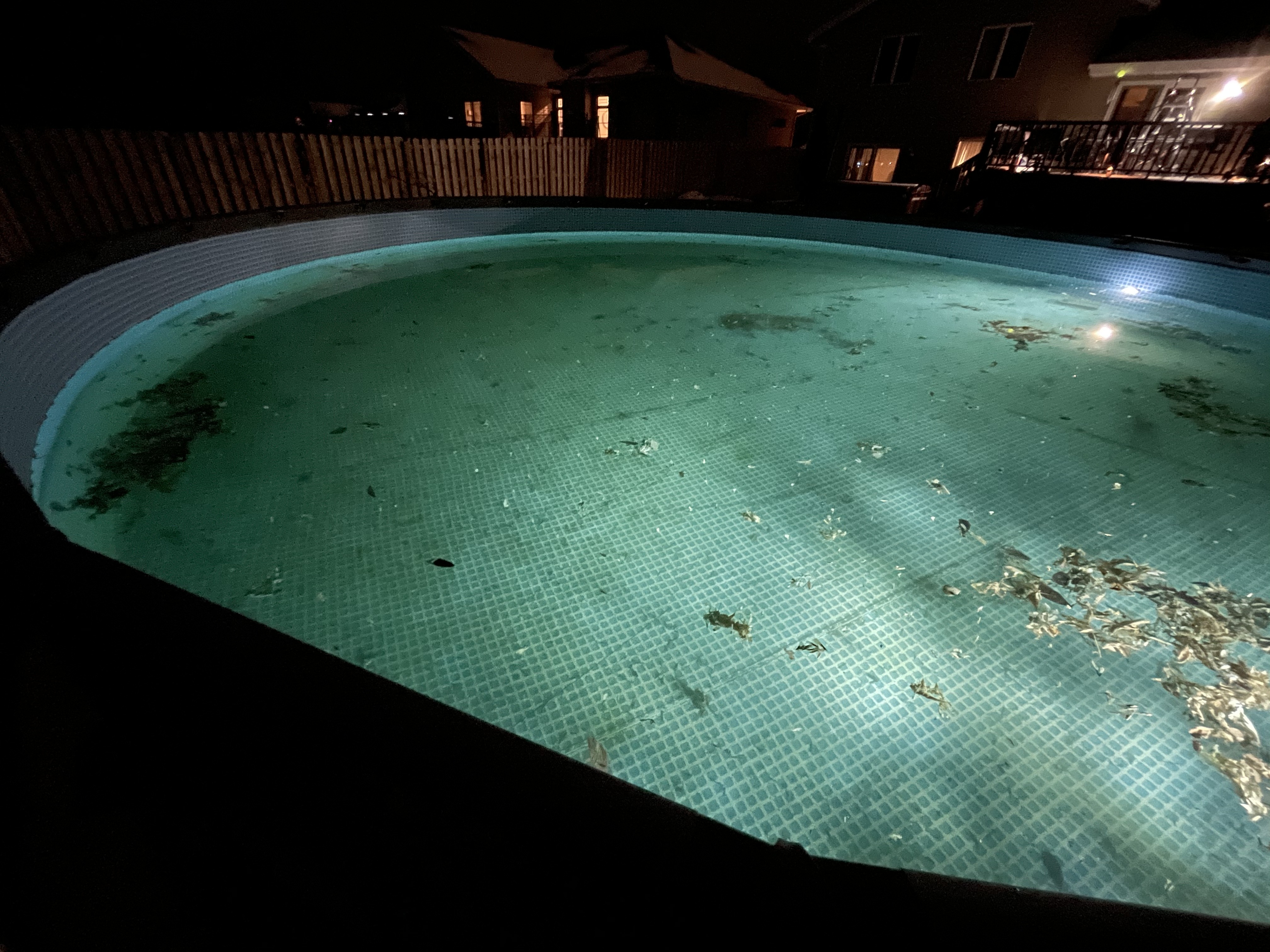

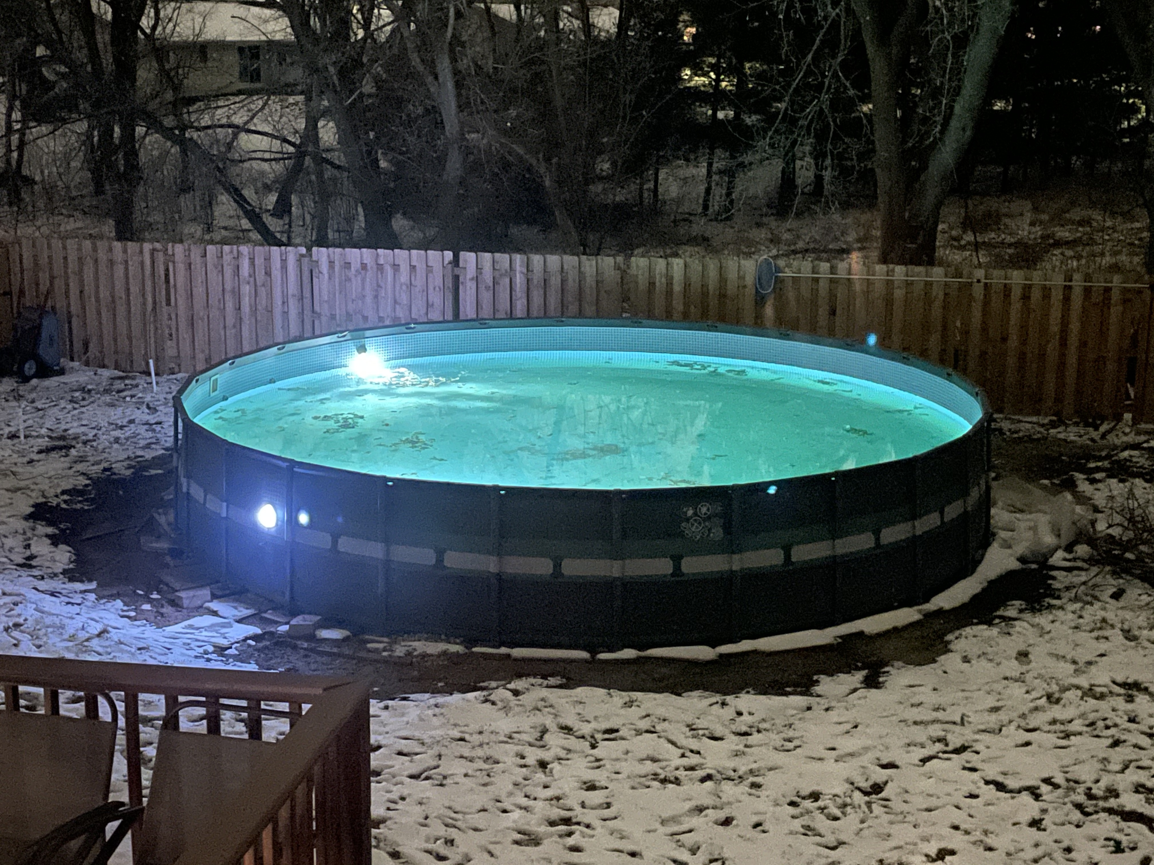

Lights! I realized the pool had melted, so I should try the lights! I put a single one in to see how it would look, was underwelmed, got the second one, and the lighting is decent with the two of them.
I'm still blown away how good a job my phone can do with night photos, so keep in mind this is slightly exaggerated compared to the naked eye. The side furthest from the two lights is dim-ish, but still perfectly adequate to see a person, so I'd say the lighting does what it's supposed to do. And once the pool is full and the lights are further below the surface, refraction will probably increase the total amount of light in the pool.
View from up top, with really exaggerated lighting. However this shows both the inside and outside lights. The outside ones are pretty dim in real life, so they won't glare into any house windows but they are just enough to see where you are walking when coming up to the pool.

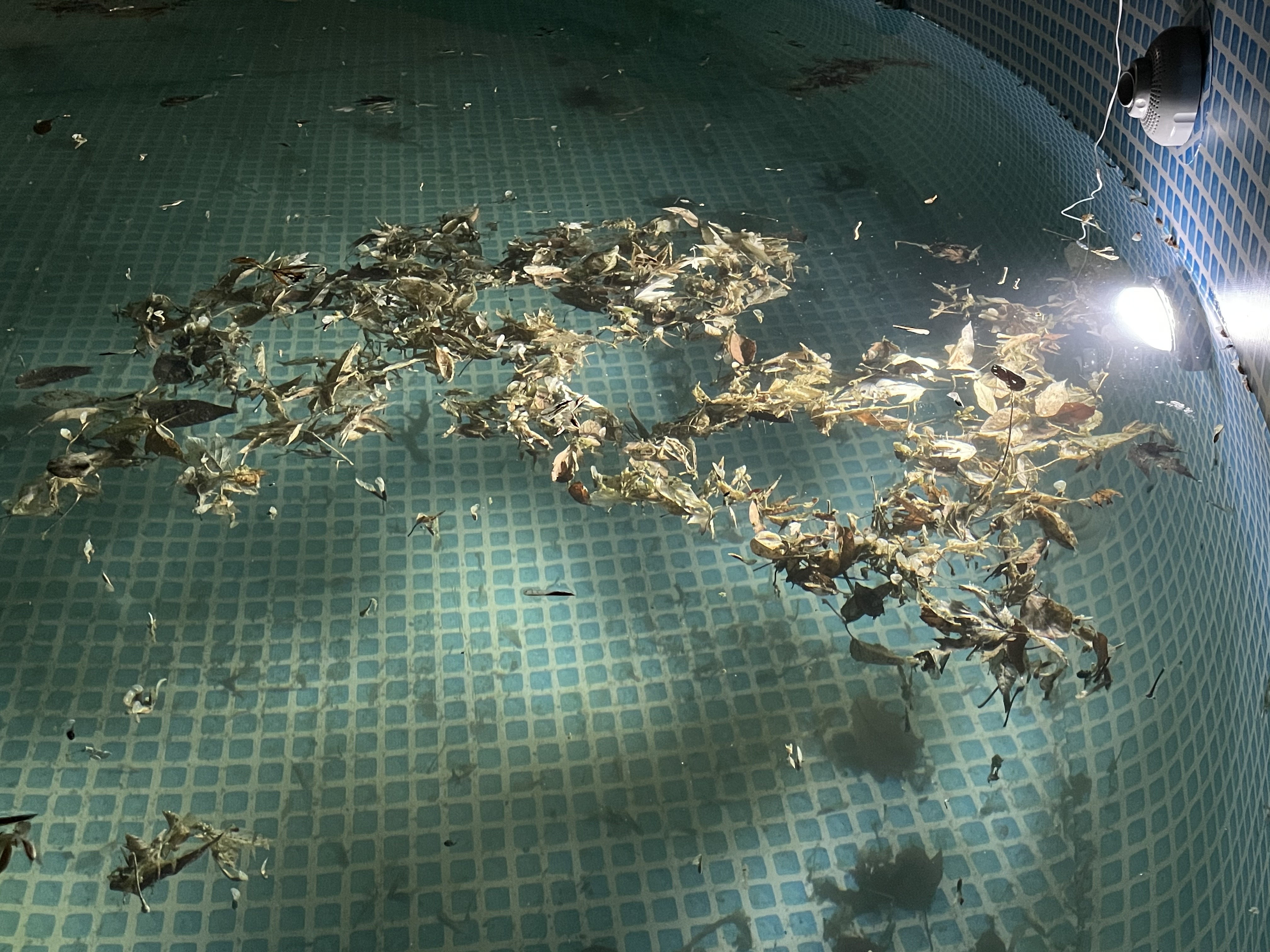

Then there's this weird thing going on in my pool. It's hard to tell in this photo but these leaves are floating halfway between the bottom and the top. And they are doing it all over my pool. Never seen this before. The only thing I can think of is there's a thermocline in my pool, but it seems rather shallow for one of those to form.
Anyhow, yes, I know, my pool is FILTHY! That's what happens when you overwinter without a cover under some trees. This weekend will get back up in the 50's, I'll net out the majority of the leaves then throw in the Aquabot Pool Rover Jr to clean up the bottom, cause that's shipped and will arrive Friday! I'll also throw in couple gallons of bleach and mix that in while I'm at it, just for good measure as the water starts warming up.

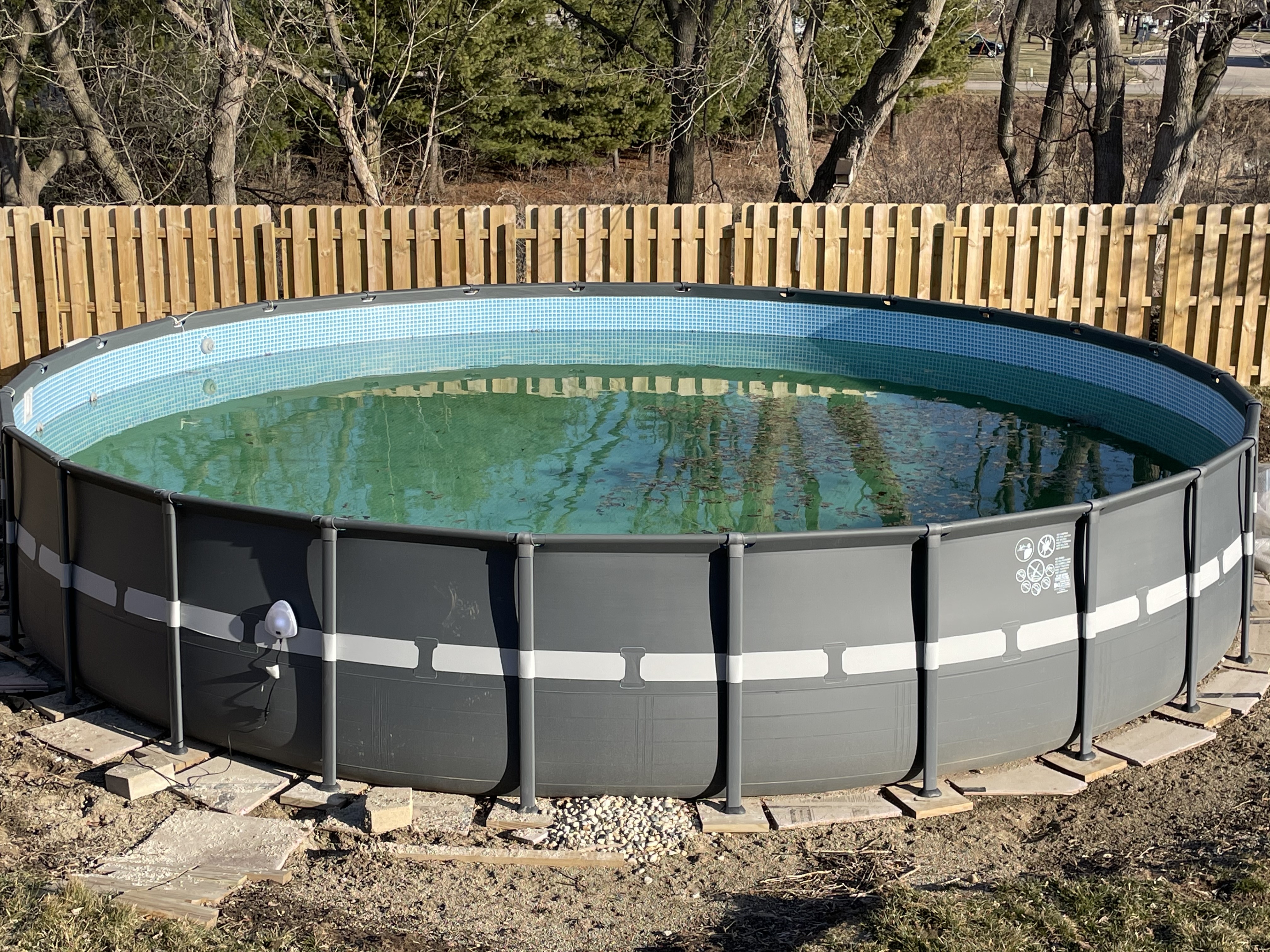

As you can see in the pics, there was a slight greenish tint to the water. This slight greenish tint is slowly changing to a not so slight greenish tint. I'll be stopping by the store to grab a few gallons of chlorine after work. If I bring it up to SLAM levels it should clear up pretty dang fast. I'll also start netting out leaves this weekend.
Unfortunately the Rover Jr was delayed and instead of coming today it's now scheduled for delivery Monday. I was hoping to get the pool all nice and shiny this weekend.
Ugh. Water temp is 42 °F. I’ll be heading to the store this morning to grab chlorine of some sort. It appears Menard’s has 16 gallons of their 12.5% $3.99/gal chlorine in stock, so I’ll check there first.
My CYA is at 20, so I popped in 154 oz of 12.5% and brushed it. That was for 10 ppm of FC, but I forgot the pool is low so it's a bit higher than that. In any case, this is the pool now!

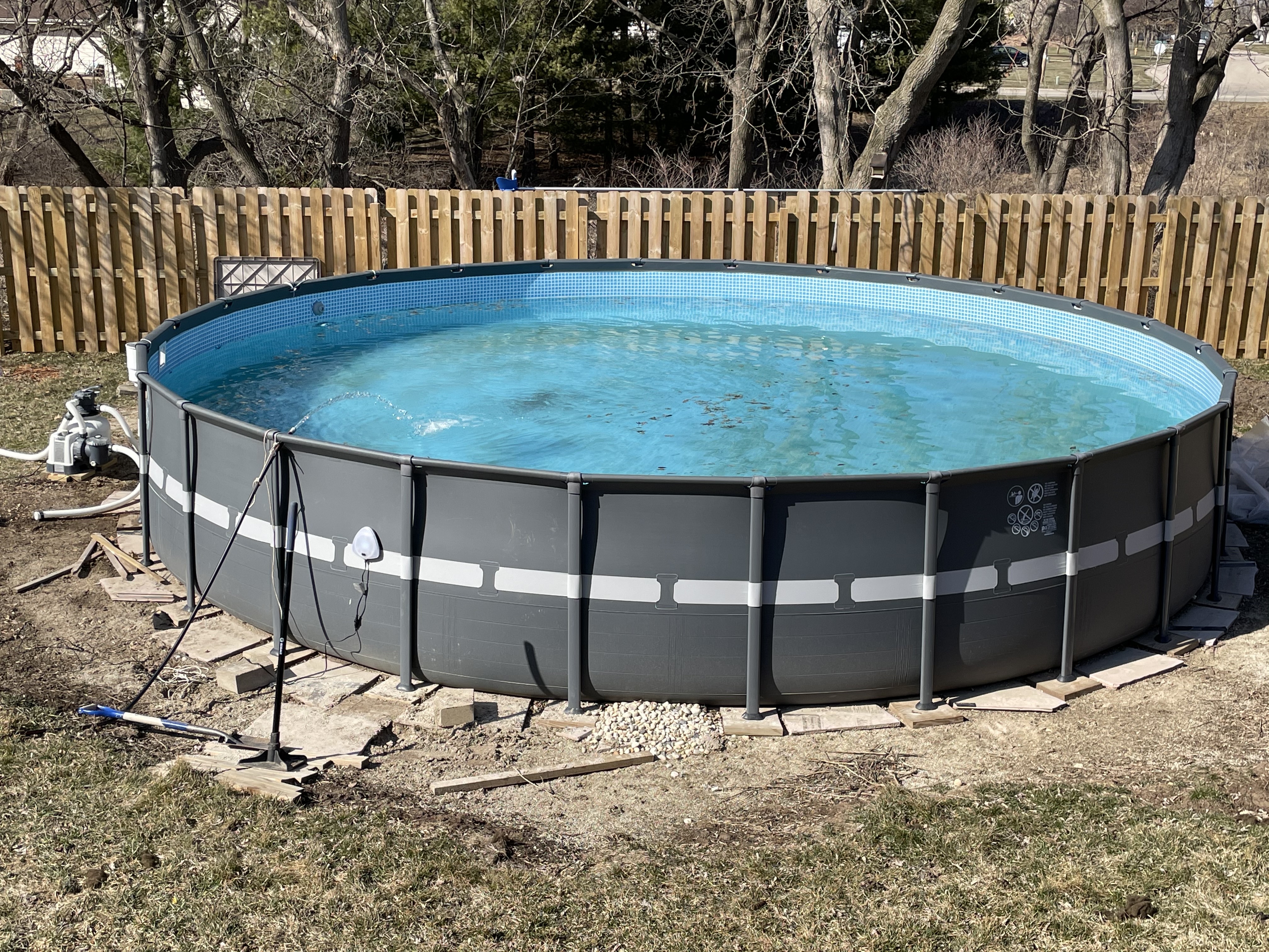

Note that it is filling. I figured with it going green already and all the leaves the best way to deal with it is to open it! So I drug out the pump and filter and started putting things together.

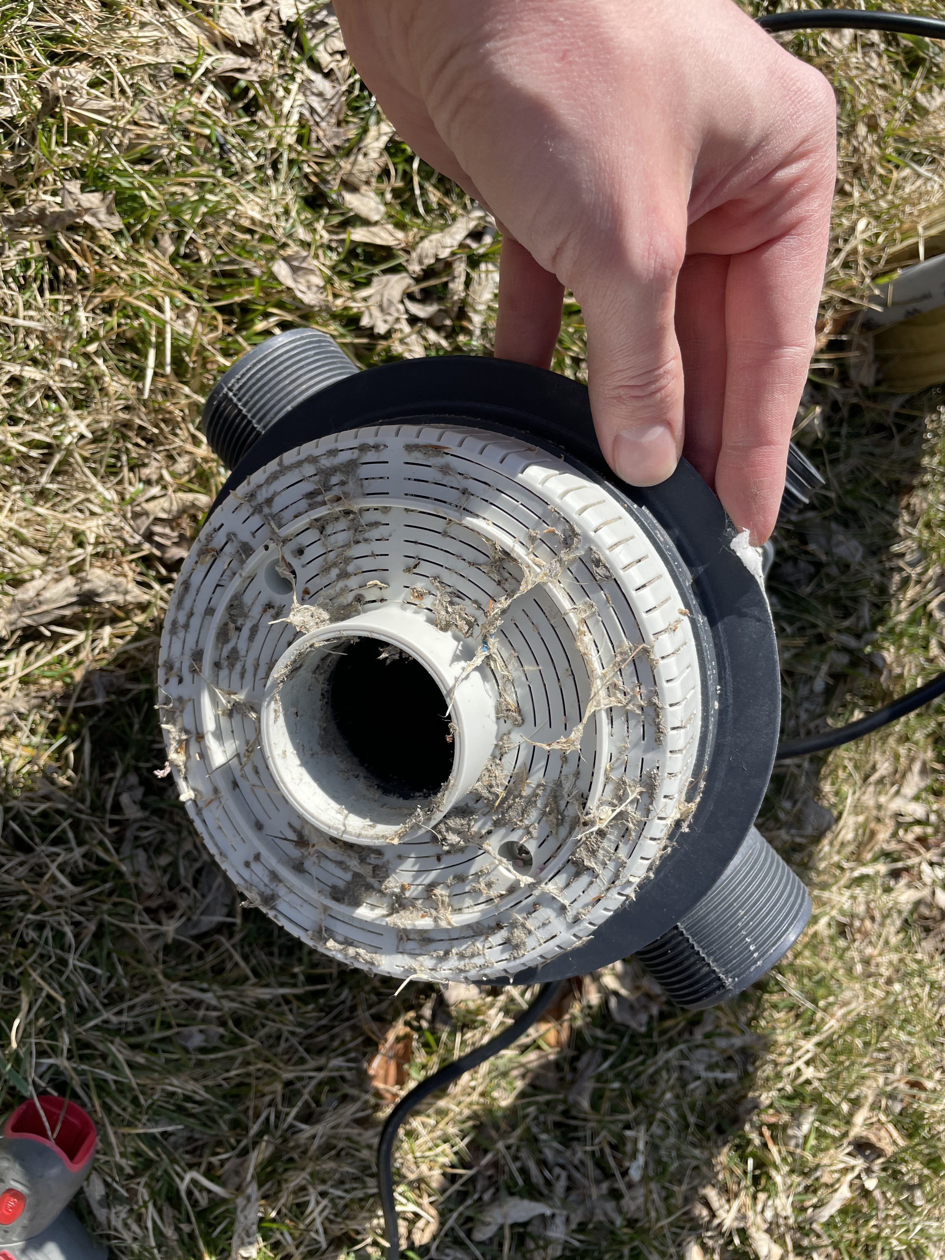

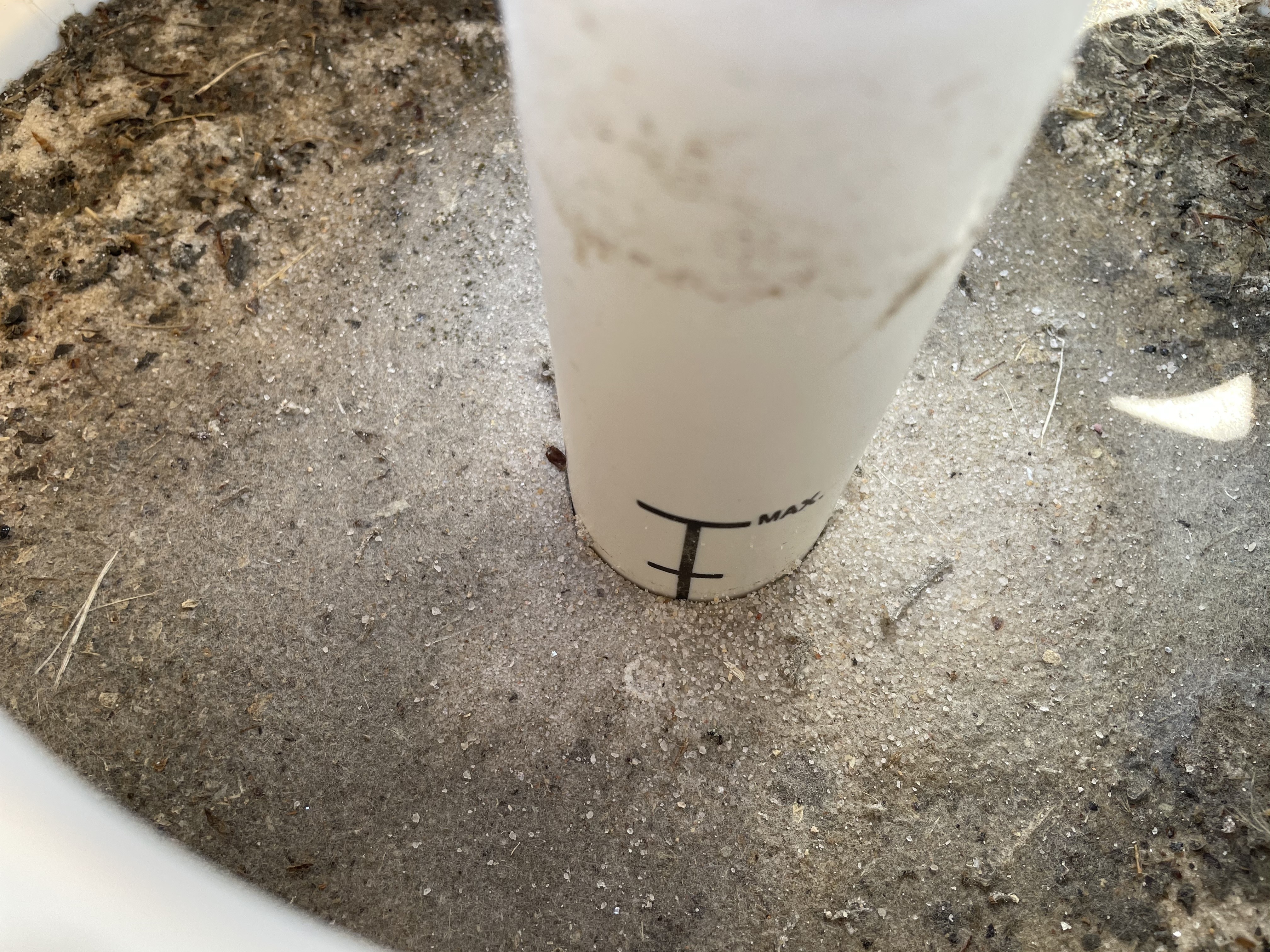

First up I opened up the filter to check the sand level. About 1/4 the way between min and max. Also some "fibery" stuff on the surface. I skimmed off the junk on the top of the sand with my hand, at least the majority of it, then topped up the sand level.

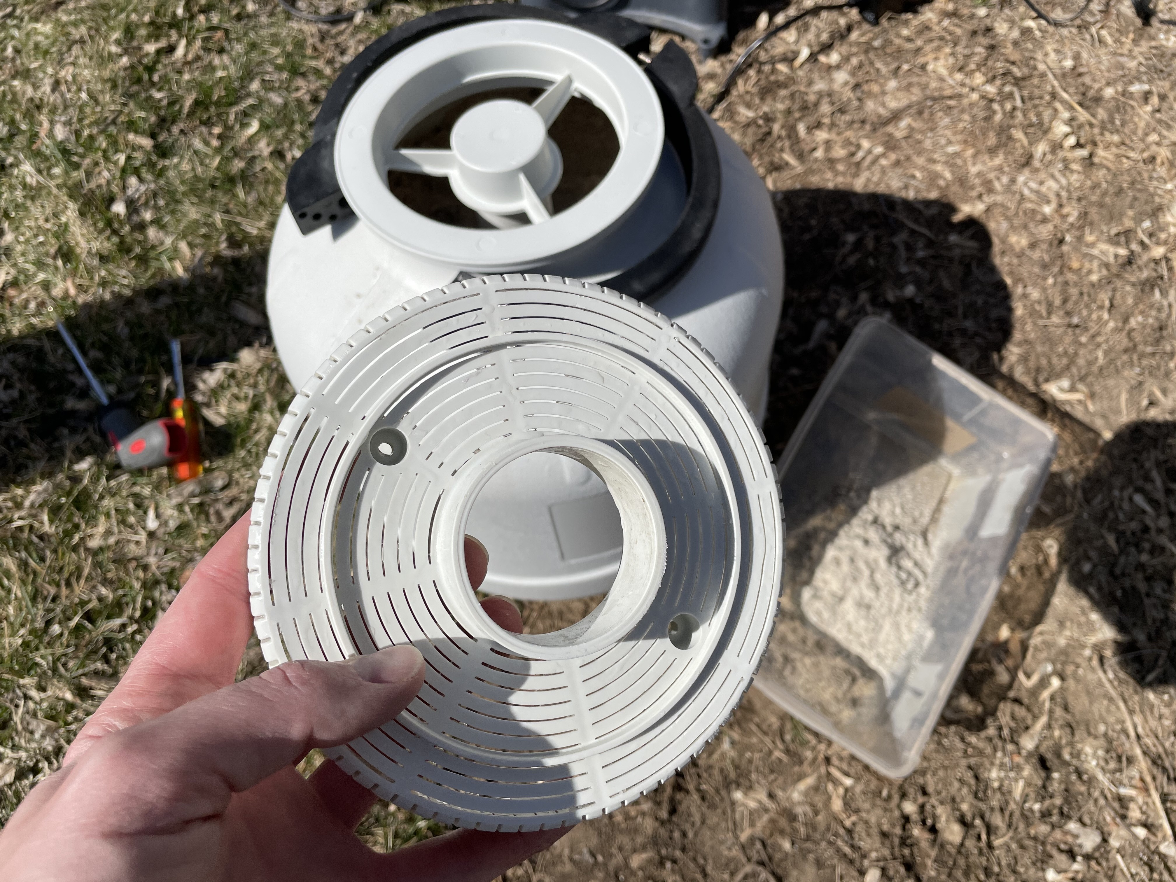

Whatever fibery stuff this was, it was on the multi-port filter screen. So I took it off and pressure washed it, after trying to use a hose but it wasn't getting it all out.

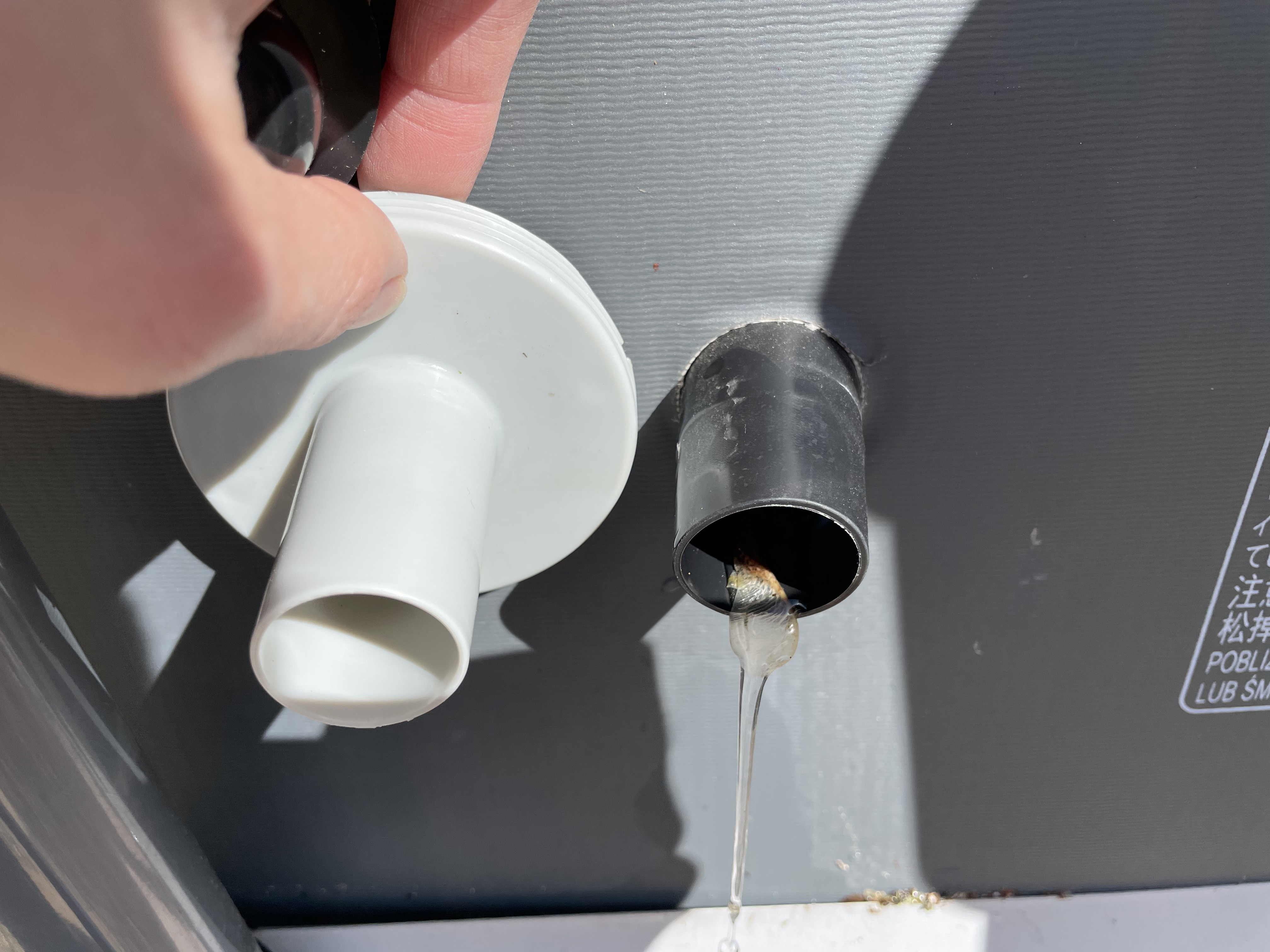

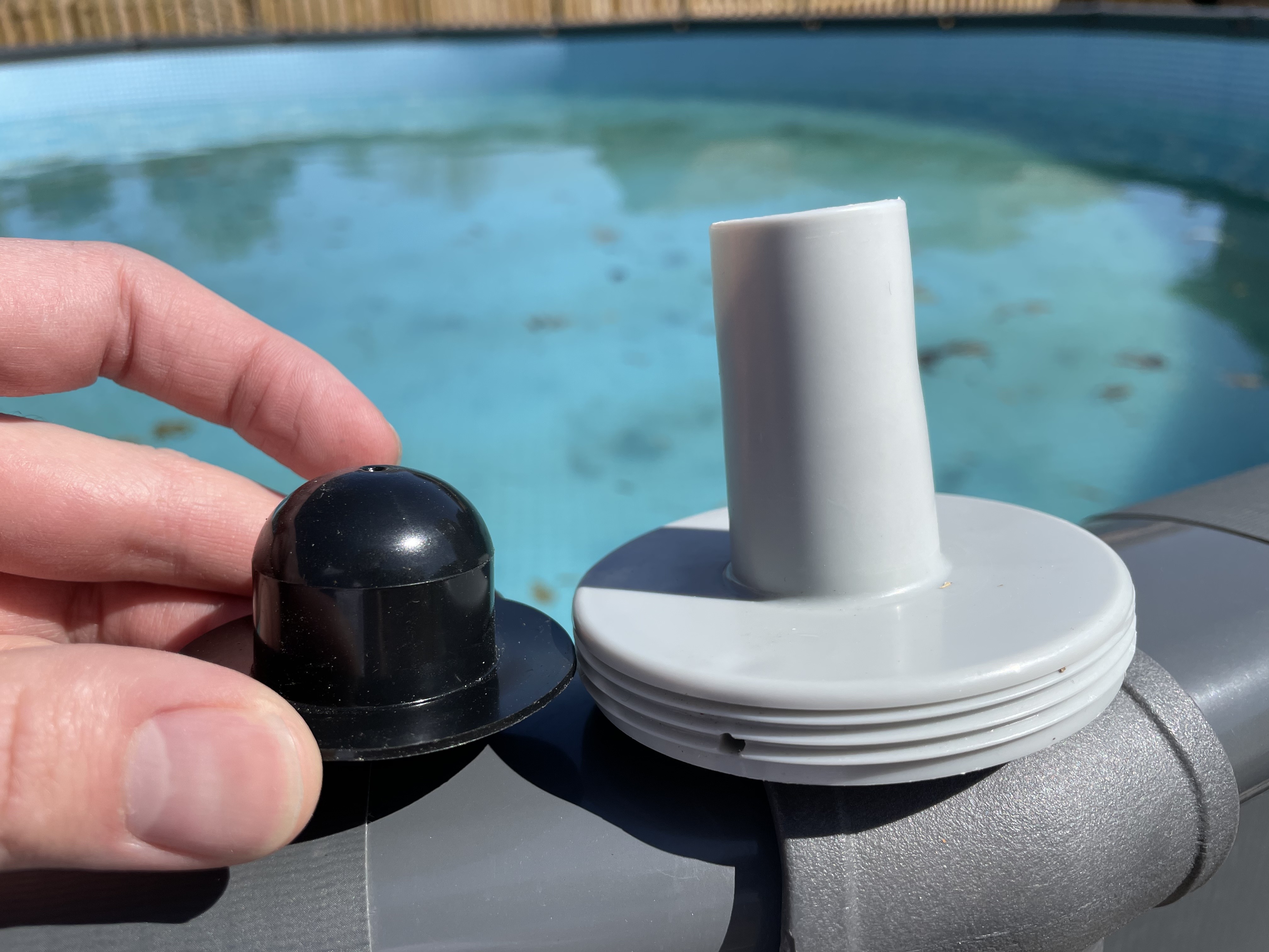

I haven't been using these intakes since I installed my skimmer so if I could just figure out a way to plug them I'd be all set to fill. The way it works is there is a rubber tube that's glued or welded to the wall of the pool. A hard plastic pipe with a screen slides into this from the inside of the pool, and the hose goes over the rubber tube and clamps down on it.
I remembered I had some plastic plug looking pieces, so I looked through the "leftover" pool parts box. There were two black plastic plugs, labeled as "intake screen plugs" or something like that. They looked like the right diameter so I slid them into the rubber tubes from the inside of the pool and after a little bit of filling it looks like they seal just fine!

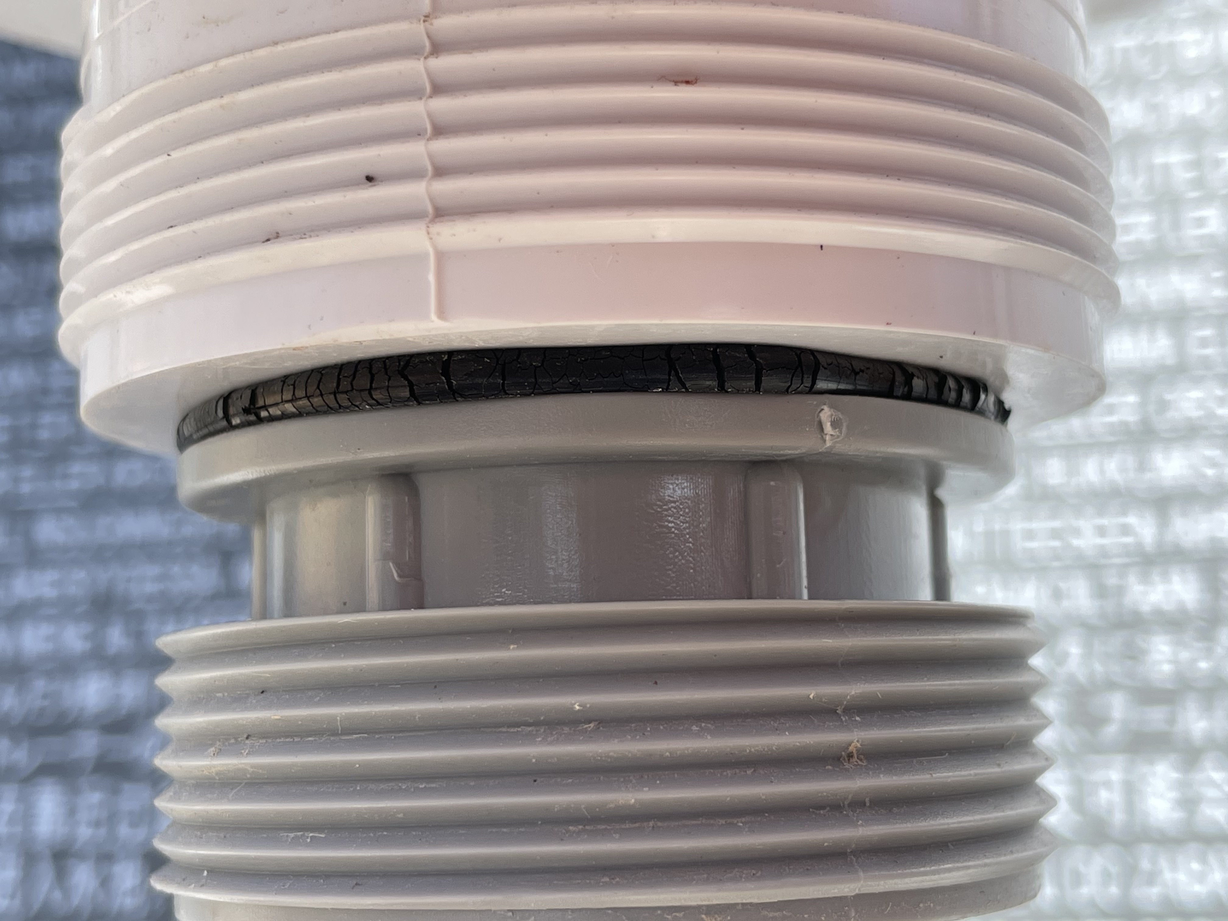

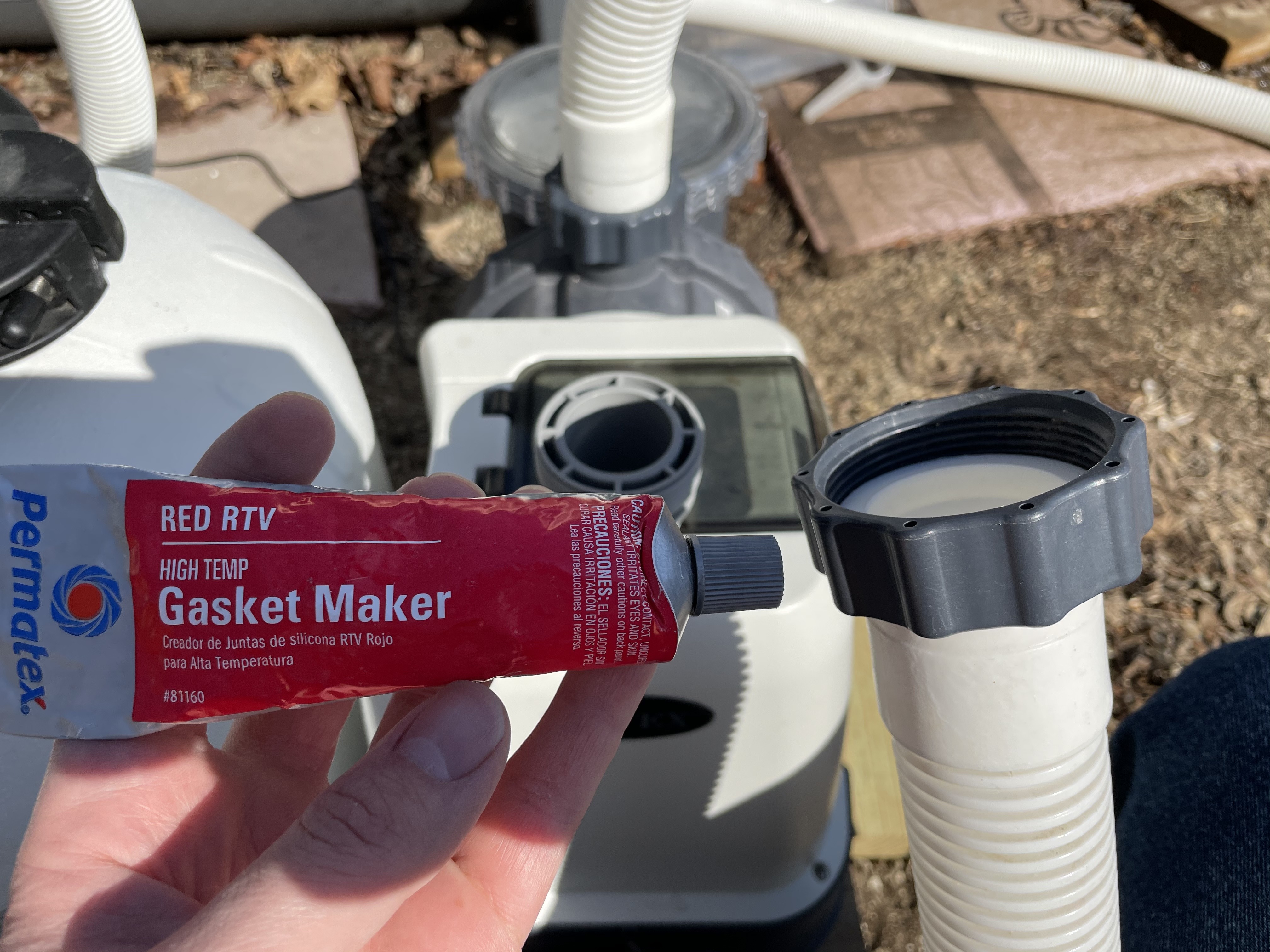

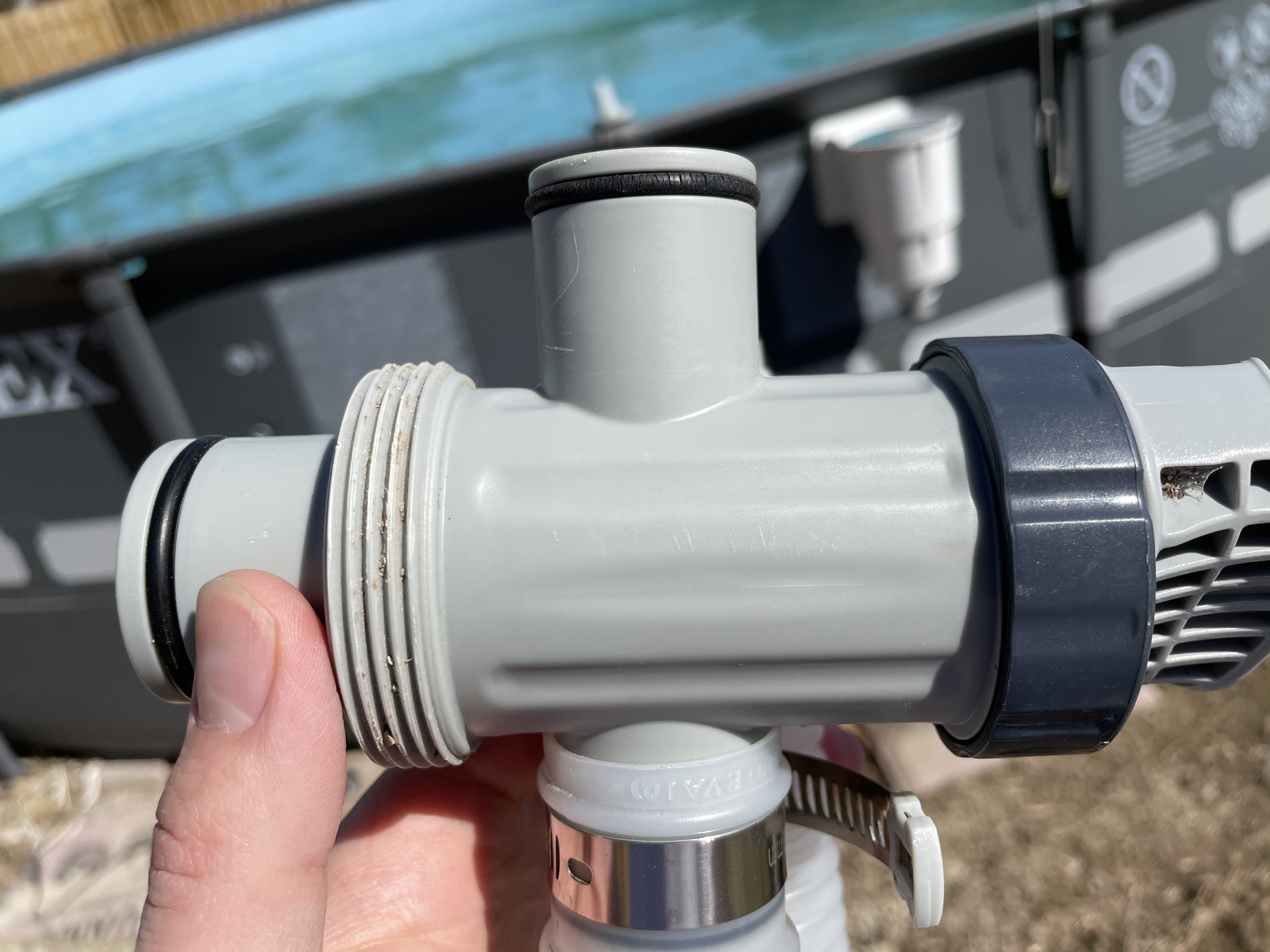

Then that left the skimmer connection. If you recall from last year I got an adapter that screwed into the skimmer and the Intex hose screwed into that. But it was a cheap adapter and I had some trouble getting the hose to seal to the adapter. Same issue this year, only I couldn't get it to seal at all. On top of that the oring that sealed the adapter to the skimmer had cracked...yet another cheap oring.
With a lack of Intex style hose gaskets and a quick search showing no orings big enough in stock, I remembered I had a tube of gasket maker in my toolbox. I pulled that out and I'm going to attempt to use that to seal the hose to the adapter and the adapter to the skimmer.
It's not meant for plastic, but if it works, great! If not, I'll have to figure out something else, but it'll delay my pool opening. The instructions are to tighten until it starts squishing out, then wait an hour, then tighten to normal torque. I applied it to the hose and the adapter, and in ten minutes I'll tighten that up then apply it to the adapter to skimmer joint. It says allow 24 hours for liquid use after applying so I'll fill the pool up to the bottom of the skimmer tonight, then tomorrow afternoon I'll test the joint and if all is good finish filling up the pool and start up the pump.
