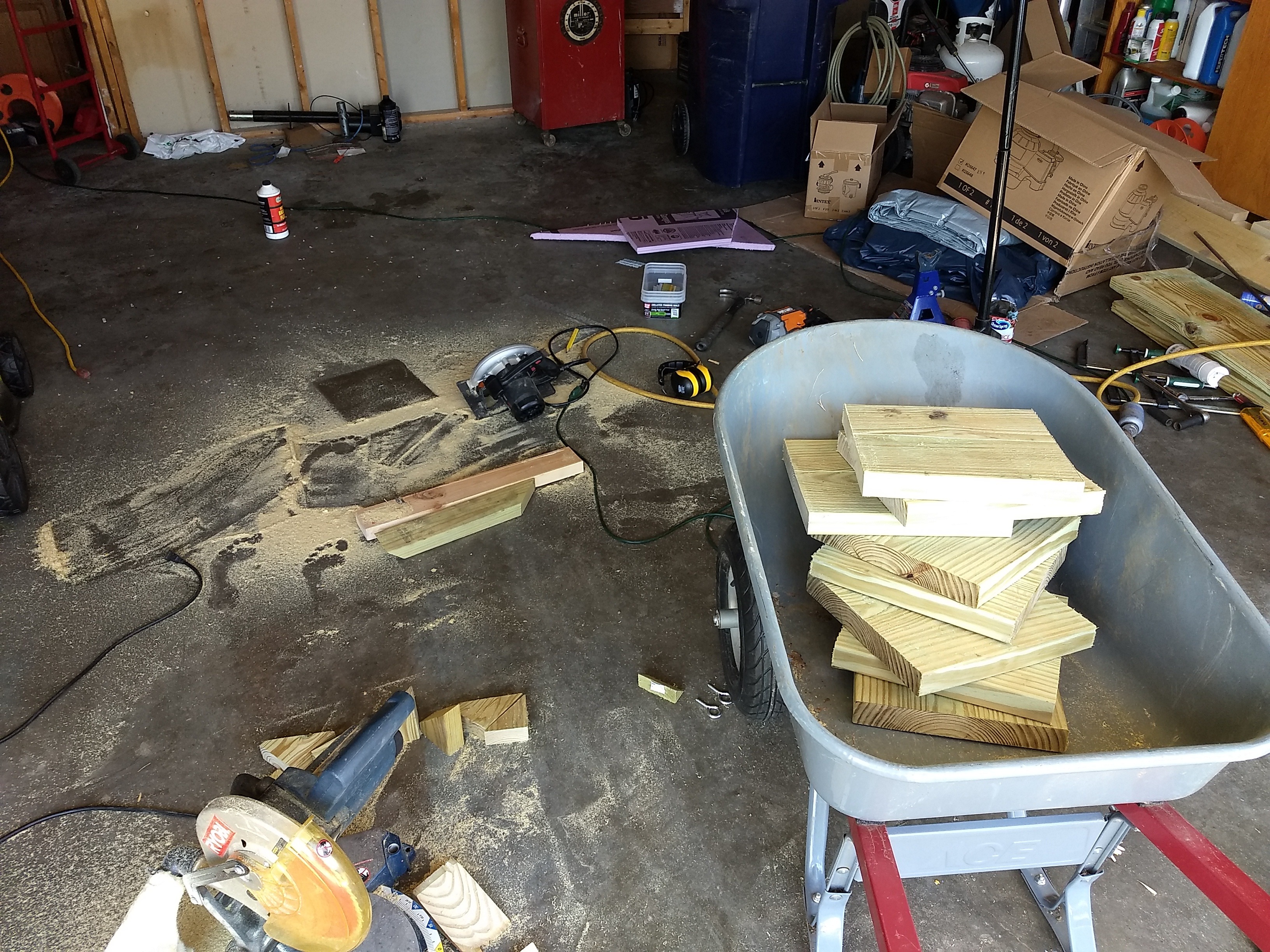

I had lots of scrap 2x4 sections left over from building the fence. With a miter saw and the air nailer in no time I had it built. One side has a large footprint, for the pool, so it doesn't dig into the liner or imprint the foam. The other side is whatever, but I added some angled pieces so it was more sturdy.
I would need some feet to go under the pool, so I cut one of the 2x12x8's into 1' sections.

Making lots of sawdust as I finish cutting the wood blocks.

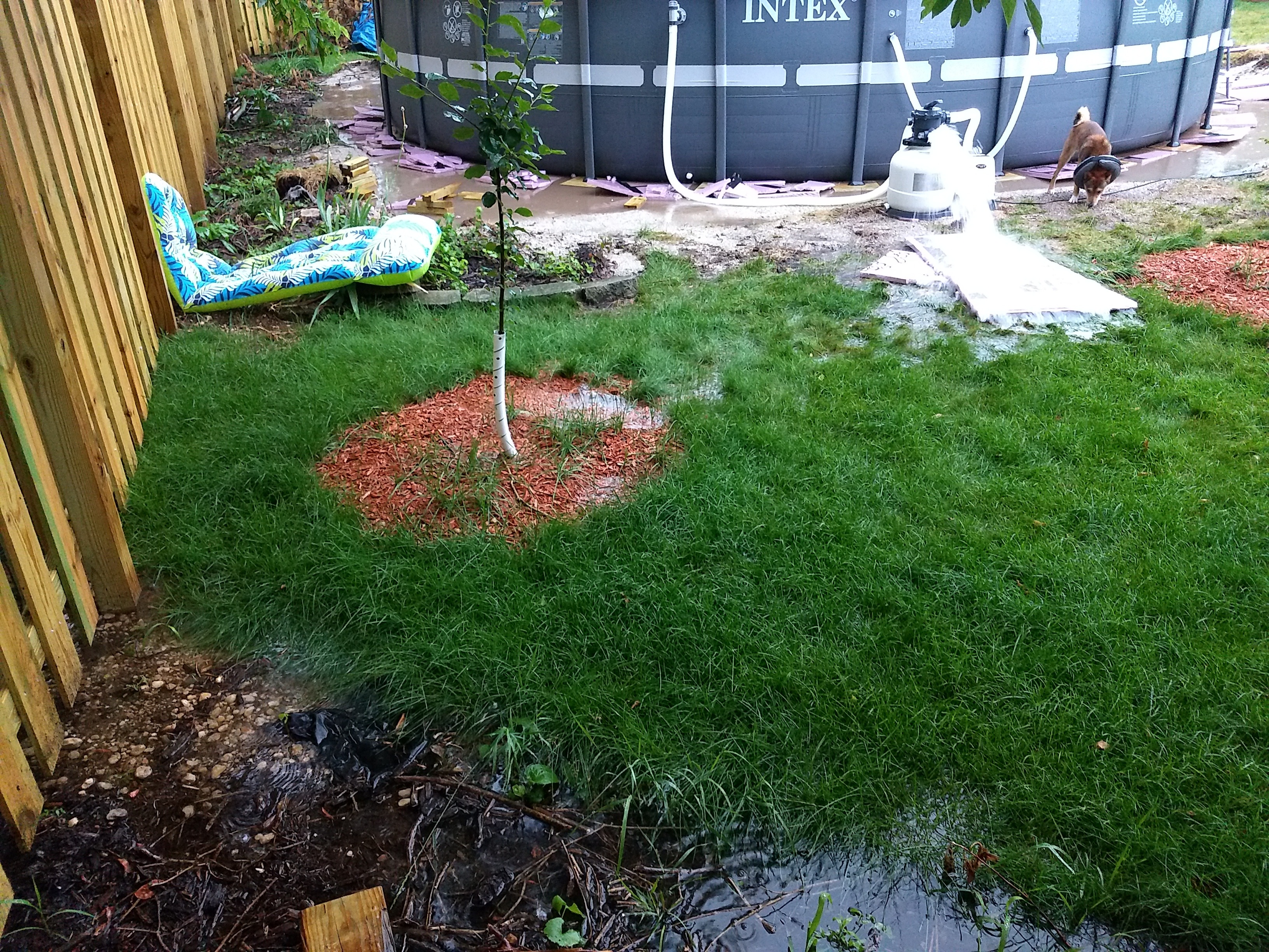

We got a lot of rain really fast while I was at work. I estimate 2.5-3" at least. The pool started overflowing.
Everything around the pool, being low as I haven't had time to start filling it in, filled up with water.
Magnet dog.
I backwashed the filter since I had water that needed to drain, but eventually I just switched and pumped to waste, as it was faster than running through the backwash. I need to pick up a long hose I can run out back past the fence into the drainage ditch behind our property.
So much water.

That is a LOT of rain!! I would look into piping it with hard PVC as we do not want doggy to run into it while playing! Put unions and valves right under the return and skimmer.
