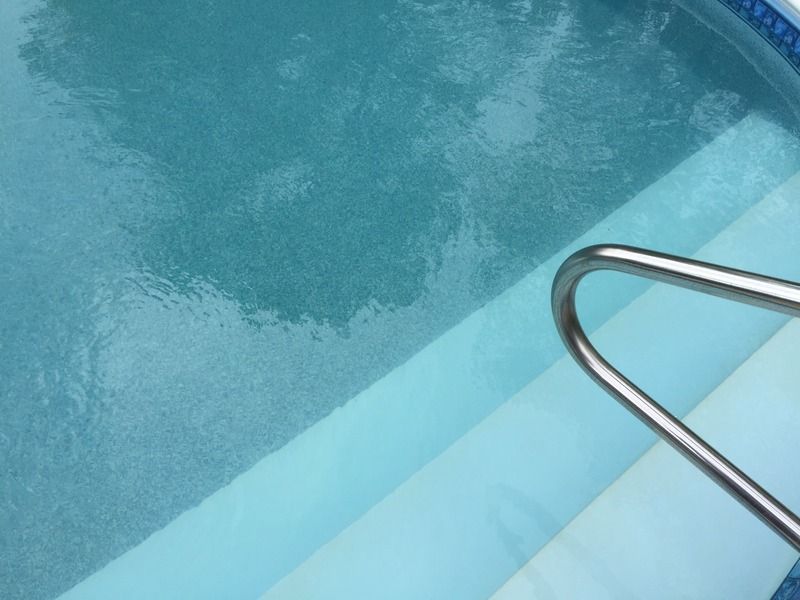

I cheated a tiny bit and put a little clarifier in there. Just a half dose. And this morning, I saw the bottom of the deep end for the first time! 2 main drains, and they appear to be safety-compliant, so that's good news. Shallow end looks pretty much perfect, deep end looks decent. Looked for DE, none of the local places I checked had it, and didn't feel like driving far enough to check the pool store 30 min down the road. Maybe I'll grab a little today if I can find some.
I have a hard time saying on the color, as so much green around messing with reflection and such. I don't think there's any green, but maybe somewhere in the Caribbean blue with hint of green sort of color, hard to describe. But fine when looking down on it. And don't have a deep blue liner, so that's not helping with the color contrast like some others would.
Either way, going to just keep the bleach up and let it ride a few more days, will see where it goes. Deep end isn't perfect yet, but can make out all of the details and the drains/angles, so definite improvement!
