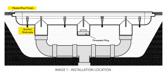

These have over 200 GPM for wall application on the outer two ports so you could get away with just 4. At 32" they could easily fit on one of the short walls near the floor transition. The outer two ports can be combined into a 3" tee then 3" to the 6" manifold. Or 8x2.5" lines directly to the manifold.
