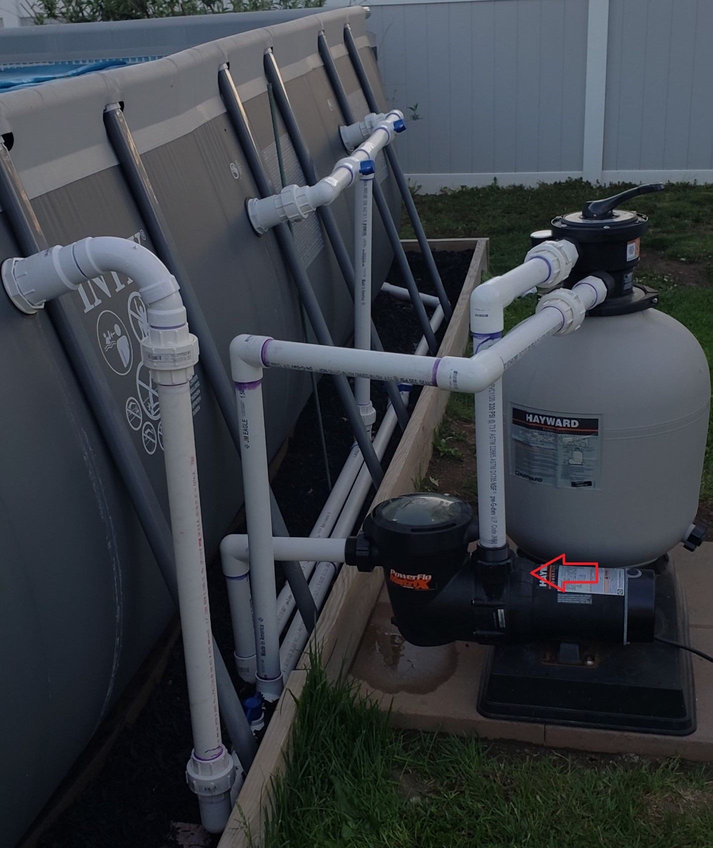

As long as the ground is not pressed up against the pool or the legs themselves you should be fine. As with any pool you just need to make sure the ground is level and prepped properly. There have been numerous threads with installs being below grade or a deck completely surrounding the pool. I would put up some sort of retaining wall/boarder to hold the ground back as I did this for mine. What is wrong with my install and that will be corrected is the boarder is up against the pool legs. This places the pool legs on the outer parts of the pavers putting unneeded pressure on them and eventually sinking the one side the legs are on. The correct way is to get the legs on center of the pavers/base so the pressure is evenly distributed.

Something needs to be placed under the legs as they cannot sit on the dirt. Pavers are just an option as you can also use pressure treated wood. But like the base of the pool, preparation is important. Whatever you decide to use under the legs make sure that the legs are centered on the pad. You want to try and displace the pressure across the entire pad. If you look at mine, I failed and had the weight of the pool at the edges and after time they sunk making the pool uneven. If you do use pavers, I recommend 16x16x4 The thickness is important to handle the weight. If you cannot find them, you can try putting down 6" of pea gravel and use (2) 16x16x1.x stacked as I have used this in the past and it has not cracked the pavers.
