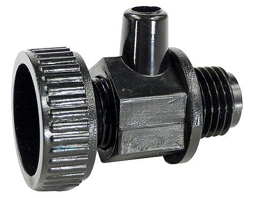

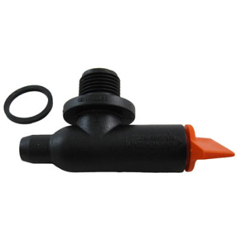

I am looking for an air relief at the filter and I can’t seem to find it.
I swear I’m not a dummy. Ugh.
