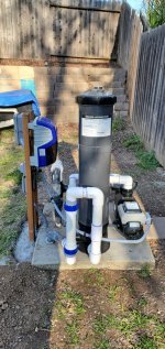

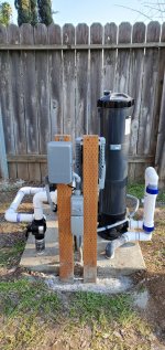

UPDATE:
I got sidelined a zillion times, plus it took 3 times the work I expected. But I finally got the entire equipment pad replumbed and rewired.
It's a tiny little equipment pad (3x3?) so working within the confines of that was not all that easy. Original plumbing was done stupid (comes up through concrete), and left very little PVC to work with. I had to get creative with my placement of things.
I finally started the system up today after 4 months (and 4 months of having no pump/filter) of on/off working on this mess. And IT WORKS!
All that is left is to do is install the salt cell and paint my pipes.
Oh...and come up with some sort of shelter for the SWG controller and timer box.

Mama,
Nice install even with the limited layout! Your RJ 30+ is a great choice. I installed mine 3 years prior to selling the house and it was fantastic. Started at 40% and it was still set there when I sold. You've gotten a lot of great advice so I only have the following to offer:
  • Get a Taylor K1766 salt test kit and only adjust salt based on this test. Your readout on the unit can be off a lot as it ages.
  • Use Pool Math to calculate adjustments for run time once you get your % Power set.
  • Try not to "over manage" your FC level. It's OK to let it run a little high but you never want it to get to minimum. Mine cycled from Target to max over time. Never got close to min. Also never had an algae outbreak.
  • Stay withing TFP ranges for balance and watch the calculated CSI level. You'll get the hang of this so you can keep the calculated number slightly below 0. You can play with your Pool Math app to see how to accomplish this with small adjustments to pH or other levels.
You're gonna be amazed at how easy swg makes pool maintenance. But do keep testing at least weekly just in case.
I hope this helps.
Chris
To be clear, he means after you've fully learned the system and how your pool responds to it. You neeed to monitor it daily for quite some time to get that experience. You'll adjust too high, catch it tomorrow, adjust to low, catch it the next day....... yeah. Simple stuff but still a learning curve like anything else. Once its all dialed in and you know how to look for the next change in daily demand, THATS when the magic starts, week after week after week..... its just..... still ok. You'll feel so important when you finally need to adjust it on week 5. Then 3 weeks after that.
But it takes a minute to get there so stay on top of it in the meantime. :)
