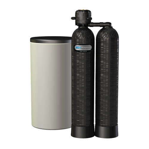

Thanks for the input. The water softener is a fancy one, the Kinetico XP:
It costs about 7 grand, and it never stops providing soft water, as each channel (left and right) regenerate separetely, so when one is regening, the other one is still providing water.
I tested the water with test strips. I tested both the soft and hard water like 5 times each, and the tests results were consistent. The soft water had no hardness at all (at least not detected), the hard water was at the last color of 450+ ppm.
