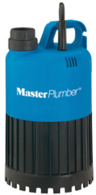

Any recommendations on purchase vs rent for a sub pump? Models you recommend?
I picked up this one at my local hardware store. You can probably find them for less cost on Amazon and other places.
It is helpful to have around the house.

If you place a low volume sub pump in the deep end and pull water from there while adding water in the shallow end (through a skimmer or into a bucket on a step so you lessen the water disturbance) you can do a fairly efficient exchange. That is assuming the water you are filling with is the same temperature or warmer than your pool water. If your fill water is much cooler than your pool water, then switch it. Add the water to the deep end (hose on bottom) and pull water from the top step.
Mmmmmm.... great information to have for sure. I would also like to know where to rent/purchase a sub pump as well for future reference.

Yes. It is a slow process. If you want a quick one, rent a 2 hp sump pump from Home Depot. It will pump about 3-4000 gph. You will need to go to your street with it as your sewer cleanout will not take that rate. You will also be draining your pool. Keep the plaster wet as well as you can. Then put your hose in the pool and fill it. It will take about the same 40 hours or so.
