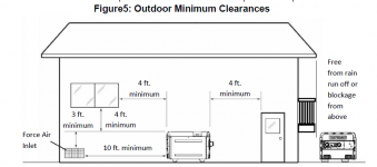

This will be my 3rd season with the pool. The past two years, I’ve pretty much just kept the heat pump off during the summer and swam. I’ve tried turning it on during the day some but I won’t keep it on at night because it’s outside my bedroom, which I think defeats the purpose.
Check on the required clearances for the gas heater exhaust from any windows or openings.
What model gas heater are you getting?
A gas heater with a blower can be very noisy.
