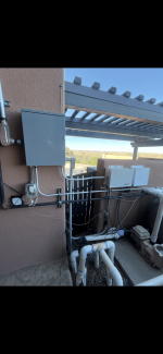

Hi all- bought a house with a pool about a year ago. Hayward SWG control box, with a “Blue Works” cell, T-3 equivalent. Worked fine the rest of the season last year. After opening the pool this spring, I was having issues with it, and after doing a bunch of online research came to the conclusion that the blue works cell had gone bad. So I replaced it with a different generic T3 equivalent from the Salt Pool Store online. I did this about five weeks ago and I’ve had intermittent problems with that cell the entire time. I went through and checked all of the diagnostic screens and verified that the voltage and the amperage numbers look right. I Made sure that my Salt content is right. I’m averaging somewhere between 3200-3500 reading on the Salt equipment, and independent testing is right at about the 3400 range. It will work fine but then after 24 to 48 hours, I will come out and open the box to see the “inspect cell” and “low salt” lights either lit up solid or flashing. When I go through the diagnostic screen at that point, the instantaneous assault reading is zero. So I can turn the generator off and then back to auto and everything will work great for 24 to 48 hours. The instantaneous reading will read correctly, The “inspect cell” and “low salt” lights will go away, and my free chlorine levels will rise in the pool. I took the Cell out and inspected it and they didn’t seem to be anything wrong with it at all. It’s had almost no buildup. I cleaned it anyway, and I was sort of optimistic because this last time it worked for a little more than 48 hours, but just checked it again this morning and had the same warning lights. is it more likely that I have a bad Salt cell or something wrong with the actual control box or something else?
