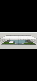

No, I think the drawing just came out like that. They are both aluminum frame with what they call “super screen” which is tougher but really it’s just polyester screen material. The stand has the long end support beams 8ft apart. The clear view has the long side 12’ 36’ 12’. So the “viewing “ is a way less obstructed but the cost is about 7k more. I just keep telling myself we have come this far so I want to make this thing right. It’s going behind a new high end house build. I know what I want to do ……😂😎
Gotcha now. (y) I was torn on the apparent roof (which isnt one). If both are all screen, more/better view wins everytime.
Depending on the view you will have when looking out. If it is just another house/fence then standard. My question to you is this............how long will your view stay like it is? Who owns the land behind you?
What color is the aluminum framing?
The darker the color, the less likely the human eye will see it when focusing on objects or the view at a distance beyond the framing itself.
That being said, (cost aside) I do like the open look - if your view isn't going to change much, it may be a good long term option.
We own all the land around it’s a total of 14 acres on the water. It’s a peninsula with water on 3 sides. The land slopes down to the water with nice woods that we will be thinning out for a better view. I do think the larger viewing area would be nicer. The big bifold door under the covered porch is 20ft long 9ft high which will open the entire living room wall open with pool view.
The framing is black in color with black screen. Appreciate the input!

I've just jumped in here and your pool is looking great! One thing I have not seen mentioned is that most screen structures are not designed for any kind of snow loading. I don't know what coastal VA is like and if it gets much snow, but I don't think it takes much to collapse these cages. Not trying to be a negative Nancy, just want to make sure this has been considered.
--Jeff
So they say the aluminum structure will hold a snow load. The tough screen will hold a snow load of 45 lbs PSF. So I think we should be ok. Also we are coastal VA, have not seen snow in years. Every once and blue moon we will get a blast but it’s been a long time. The engineers are aware, said we should be ok at 45lbs PSF. Thanks guys I will post some more pics as this moves along. They are pouring the footer for the enclosure Tuesday.
