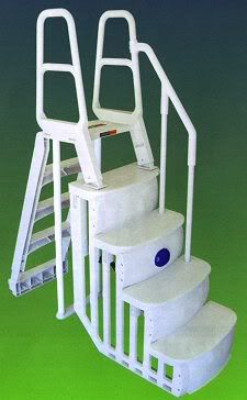

My ladder is not cake style either see picture attached to this post. I am not sure pea gravel would work on this one because there are pass through holes in the rails, but that is a good idea. There is a plate on the bottom underneath side to set weight on to hold it down, concrete bucket was convenient but I will do something else.

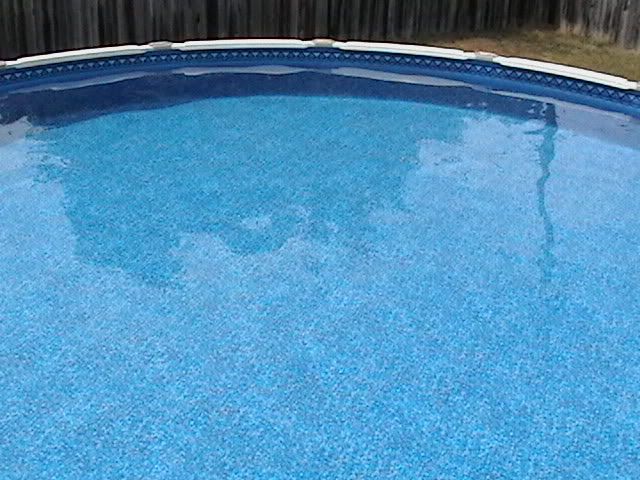

Current pool pics. looks pretty good.

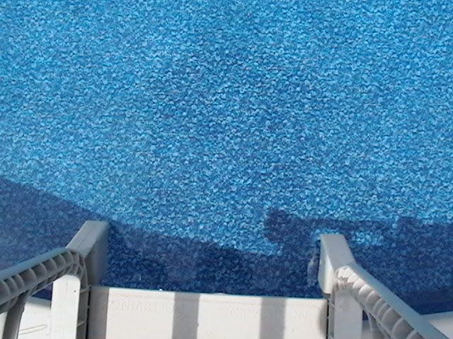

this is where the ladder was at
