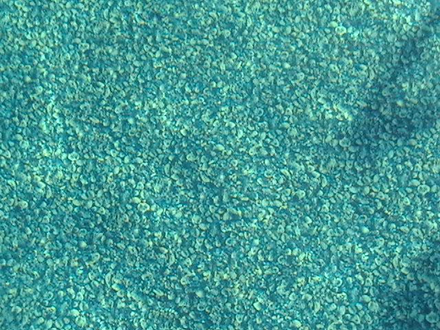

Took these pics at 8:15 AM. The last pic is yesterday afternoon, looks like a big difference but could be deceiving because of the sun. gets lighter green every day, but not there yet.

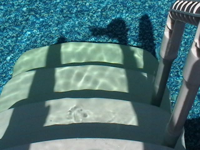

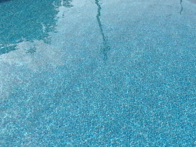

Here are two pics taken at Noon today. Just a hint of green is left. Any guesses on how many more nights and mornings I will have to shock till my FC's stay up?

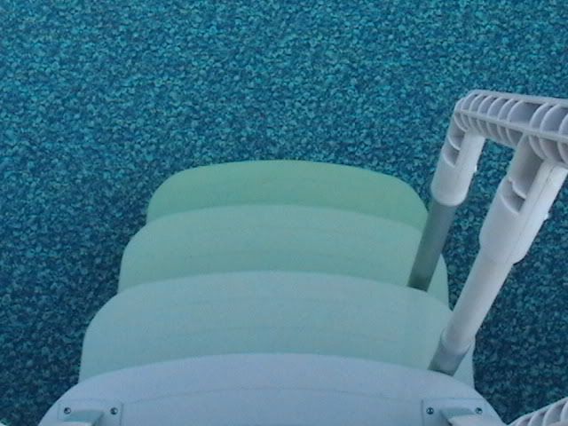

Here are pics of the pool at 5:15 today. Green is gone. Picture is a little deceiving, it looks like it might still be a little green but when you look at the pool with the naked eye you don't see any. Just have to get the FC to come up and stay up and the CC to come down and I will be done. FC's still are dropping to 5 within an hour after adding bleach. Does anyone have a comment on the previous post?
I don't know if location makes any diffference for sampling. I try to get a sample in a place where circulation is not that great, just so I know the worst case for FC in the pool. I'd guess that your choice is good.
The water is certainly looking good, now you will really need POP, for these final days seem to be the hardest; when it looks so perfect but the numbers say it is not quite done. I guess there is goo in the nooks and crannys that has to be flushed out.
