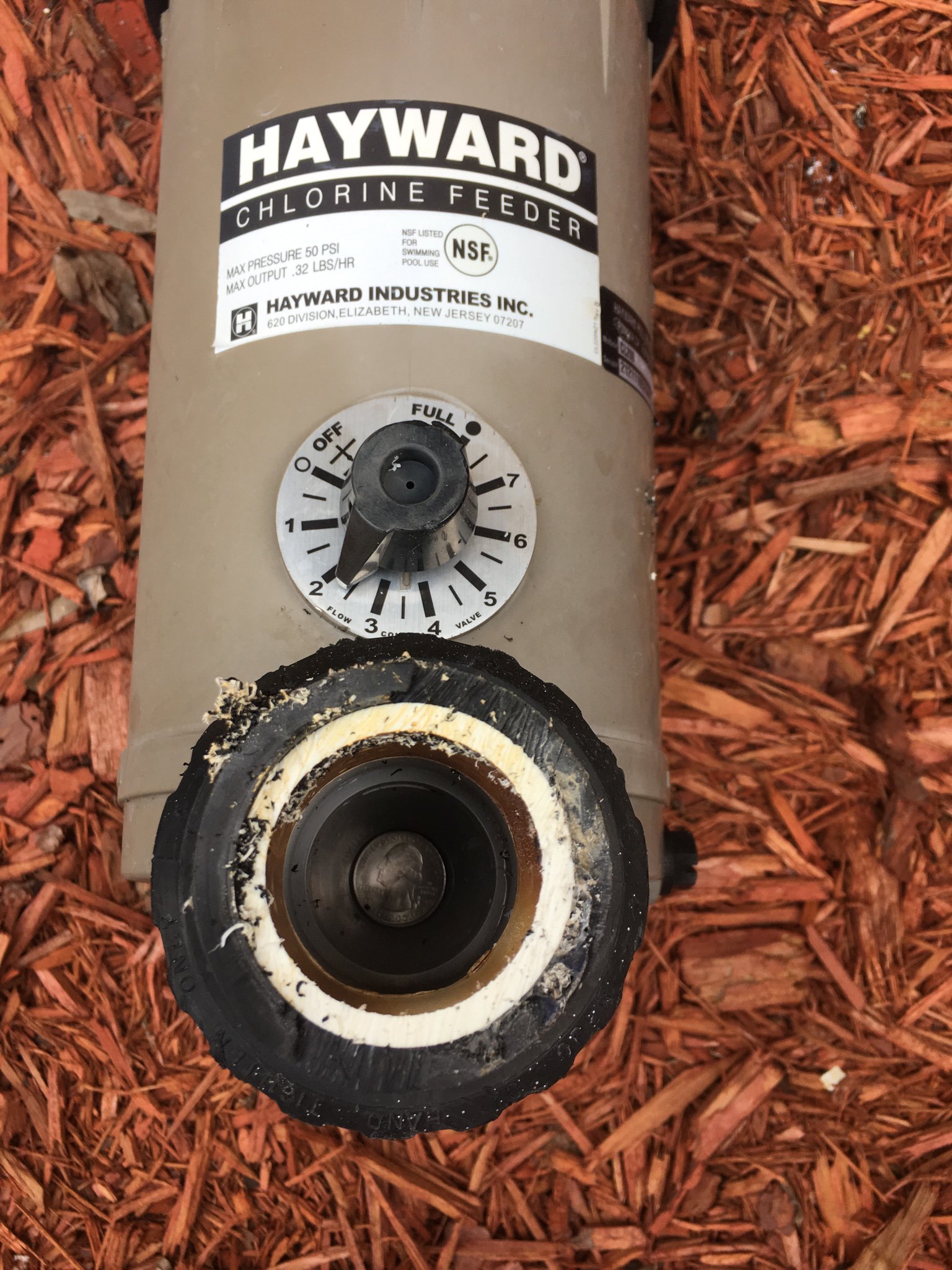

Started to plumb everything in and the rain started. Removed the old Chlorinator from Hayward and was surprised to see how far they neck down the Venturi. Basically down the size of a Nickel. Now that it's gone the pump sounds slightly different.
Hope to have a new Pentair Pump here in the next few months and will address the rest of the issues on the pad but here is how far I got today. If the weather cooperates over the next few days I will wire it in.
