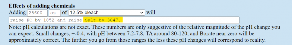

The Taylor K-1766 salt test, and all salt tests I can find, measure total salt levels which I'm assuming is a combined ppm of both Na+ and Cl- dissolved in the water (though I haven't found verification of that). This would be fine if I had fresh pool water from the tap and I was adding sodium chloride to it, but I haven't drained my pool significantly since I bought it with my house, and in that time I've probably added 200 gallons of bleach to it, which according to pool math will add about 2400 ppm of "salt". But I think the "salt" in this case is only the sodium in bleach.
But if I understand them correctly, the SWG needs chloride (Cl-), and the salinity range the manufacturer recommends is probably based on the assumption that half the "salt" that I measure is indeed Cl. I'm worried that a salt test result might say I'm currently at say 1500 ppm despite having very little chloride, and if I add salt to get up to 3000 ppm suggested by the SWG manufacturer, I might only have half the amount of chloride that the SWG needs. Is there an easy way to measure individual constituents of salt, or am I missing something?

The K-1766 uses Mohr's Method (argentometric titration) to determine the amount of chloride ion in solution. The chemical reaction is such that it is only measuring chloride (Cl-) and nothing else (... unless you happen to have iodide, bromide, or cyanide in your water ....). The silver nitrate titrant has it's concentration adjusted so that it reports values in mg/L (ppm) of sodium chloride (NaCl). This is perfectly fine because an SWG needs chloride ions (Cl-), the counter ion (the cation) is irrelevant. All cell manufacturers rate their cells based on ppm of NaCl. For example, I could add potassium chloride (KCl) or magnesium chloride (MgCl2) or calcium chloride (CaCl2) or rubidium chloride (RbCl) or cesium chloride (CsCl) to the pool and it wouldn't matter, the cell is still getting chloride ions. The cation (the positive ion) doesn't matter to the cell (but it could matter to other things, like your plaster or your health). The only difference is that the weight of what you add will change because all of the chloride compounds have different molar masses.
So, as long as your salt test gets you in the right range for NaCl concentration, then the cell is fine.
Sodium hypochlorite adds an equal amount of sodium and chloride.
The chlorine in the hypochlorite becomes chloride.
All forms of chlorine added will add an equal amount of sodium and chloride.
Even if you used chlorine gas, which only has chlorine, which becomes chloride, you would have to add sodium bicarbonate, sodium carbonate or some other sodium based base like sodium hydroxide or sodium tetraborate and that adds an equal amount of sodium as chloride.
Reactions: ArtP and Mdragger88
Sodium hypochlorite is pH neutral and you can see that it produces an equal amount of sodium as chloride.
2NaOCl + H2O --> 2Na+ + OCl-+ HOCl + OH-
OCl-+ HOCl + OH- --> O2 + 2Cl- + H2O.
