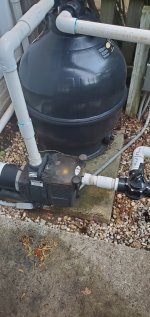

Yep don't have one of those. Here are more photos of equipment we have. Could Jangy settings be an issue? Thanks

Okay will consider that but interestingly enough the water coming up from the skimmer has only been happening maybe last 2 years on and off and we have been here 15+years with this pool. Appreciate all your help with this mystery
Update. Did some additional research and found that if there was a vortex on the actual skimmer (there was) it was because we may needed to add water to the pool itself. So we added water and we had allot of rain yesterday and woooohoooo 2 days straight the skimmer lid has not moved and water has not shot out of the skimmer like before. Vortex was bring allot of extra and unnecessary air into pool system. So for now life is good! Thanks to all.
Update on the air situation when we shut the filter and the skimmer cover shooting up because of extra air. Went on YouTube and searched air leaks in pool equipment. Came across a couple of videos where you take a hose with running water over the area you think maybe the issue. in our case we thought it was around pump, skimmer and the lid because I saw air bubbles when u looked thru the skimmer . Sure enough once the running hose was put above the pump skimmer lid, the bubbles disappeared. There are 2 black plastic nuts and o rings on the side of the motor,skimmer. One had a slight leak, Went to Amazon, found the correct replacement parts and o rings. Switched out the bad one, lubed the oring and wala....no more air bubbles, no swishing noise from within the sand filter. Just peace and quiet so much so that pool pump primes itself within 1 minute. Psi is normal and life is good 😀 and it's been 8 days.
