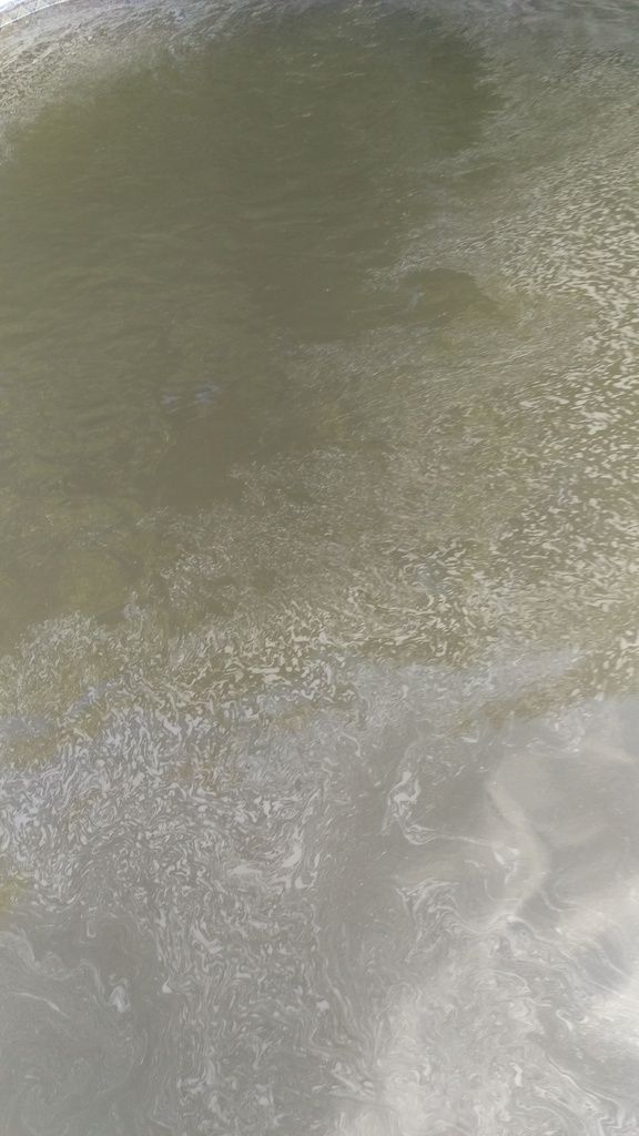

I have scooped "until the cows have come home" ! It appears (I think, I hope, I pray !) that most of the heavy, large organics have been removed. My pool guy vacuumed at my request and lots of what he termed "live algae" was on the bottom floor. Prior to vacuuming my skimmers, with knee high hose attached, were trapping large amounts of particle type debris, so that the knee high(s) were saturated after a short while. I went through several knee highs per skimmer in a short day. Post vacuuming and the particles were virtually gone. He then shocked the pool. The pump ran all night, and this morning I changed the sand. Using an old chlorine test (years old !) it indicated that the pool was holding chlorine, but it showed considerably less that last evening. I have ordered a TF 100 kit from Dave's store. In the meantime, Kim has suggested that I add a gallon of bleach this evening. Thank you!

Keep adding the jug of chlorine. Take picture looking down at the steps. That will be your "base" picture.

The pool guy is using strictly liquid chlorine, 12.5 % Champion brand shock. I have used, on two occasions, powder shock, Clorox brand. I attempted a CYA measurment with out of date reagent, and got a reading that was high off the charts. I can buy fresh CYA reagent or wait for my TF100 test kit to arrive. What do you suggest? BTW I am having trouble posting pictures to photobucket. I have uploaded a picture from my computer but it appears that the image is clipped? Is there another system I can use?
