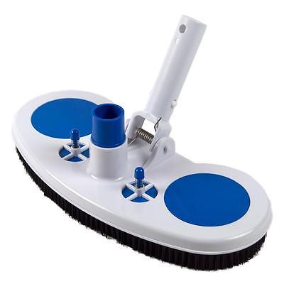

  • After the first 48 hours vacuum daily before brushing using a vacuum head with brushes (such as used in vinyl pools) instead of wheels to prevent marring the plaster. Clean filter after vacuuming. I have never vacuumed pool. I have the blue hoses and a roller vacuum from previous owners so not sure it works, I need a head with brushes instead of wheels I guess - can I get this from walmart or Leslies? What is the setting on my pump to vacuum?

4. Brush Heads
You can get the vacuum brush head at many of the local box stores. You will attach with hose to the skimmer connection and gently vaccum on the days assigned by the startup procedure. Do not run any wheeled devices for at least 28 days.
