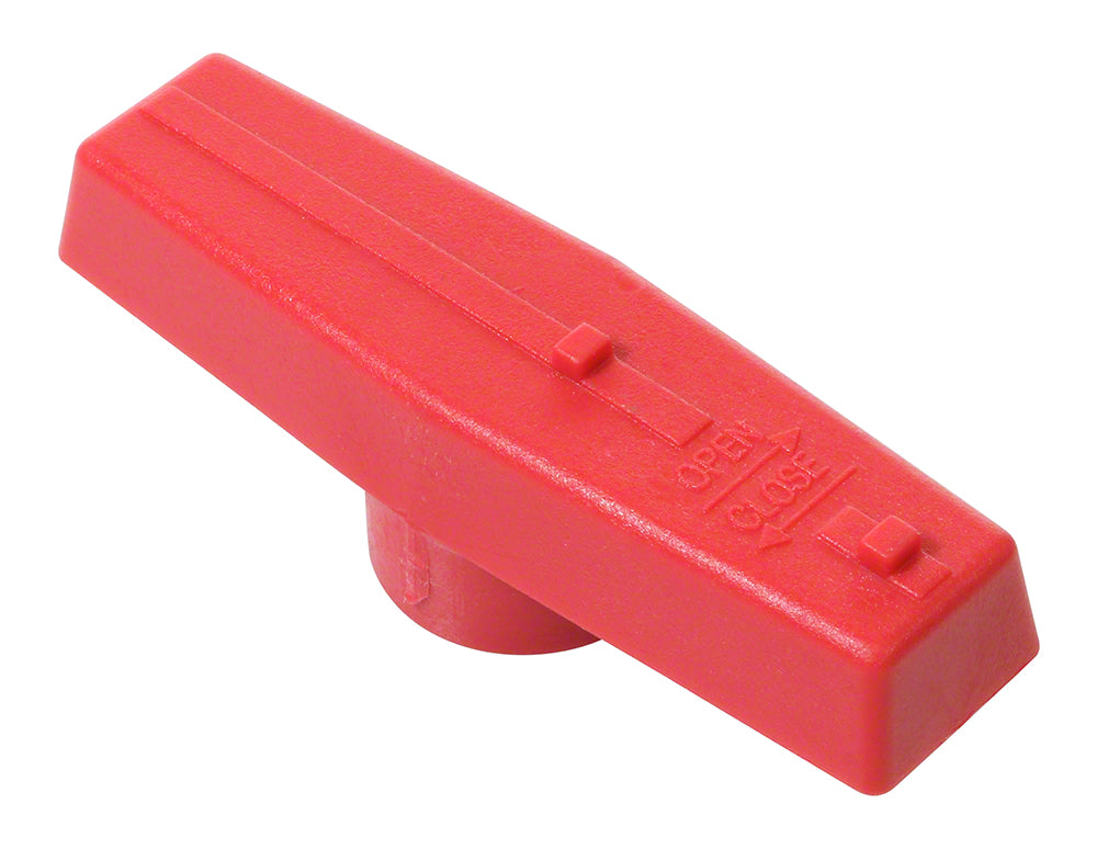

Can you pop off the handle and show the valve stem?
One of these might fit.
https://www.amazon.com/Praher-Handle-Ball-Valve-Blue/dp/B07MVZ71KZ

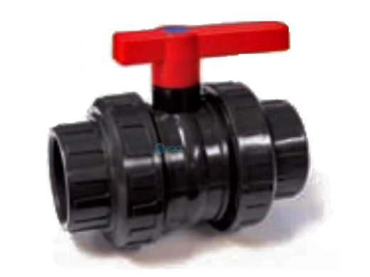

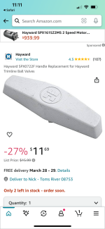

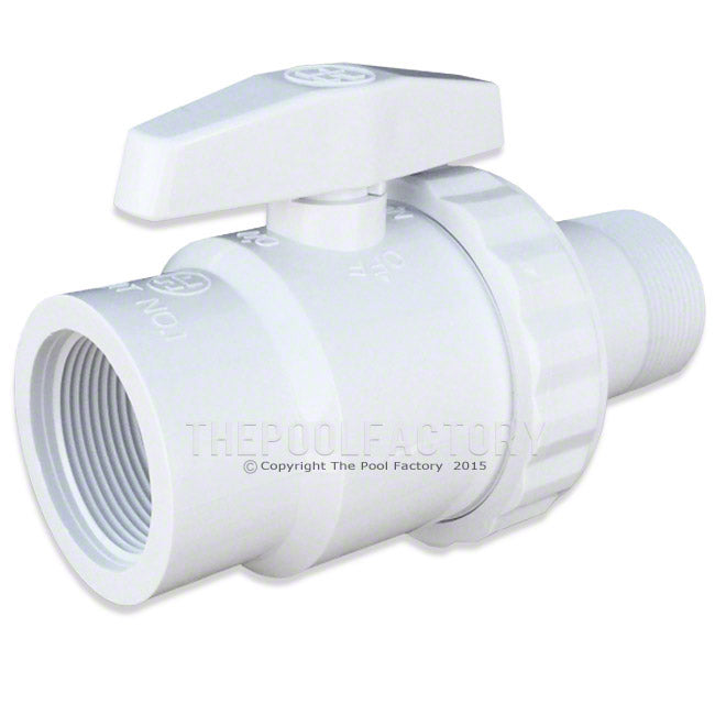

These seem pretty close.
PRAHER 150-010 1.5IN SXS SINGLE UNION BALL VALVE PVC
The handle will "probably" work.
TWO-WAY BALL VALVES UNIONIZED
25802-151-000 6955, 150-010 1.5" Socket
25802-151-080 Handle for 1.5" Socket Unionized Ball Valve.
Zodiac Jandy Pro Series 1 1/2" Ball Valve, Union. #6955
Super-Pro 1.5"S PVC Union Ball Valve, 25802-150-000
I'm late to the party, but could you contact the builder? When I lost a decrepit valve handle last year, the builder sold me a replacement handle (red Praher one like JamesW posted) for $1. We have a relationship with them because they've done a liner replacement and do our closings, so they were willing to help. That might be worth a try. At least they might give you more info. You know what a fair price would be, so you wouldn't get ripped off. Otherwise, I think the suggested items would work fine and you have time to wait for it to arrive. My handle broke in the middle of summer with the valve closed, but your early planning works to your advantage.
