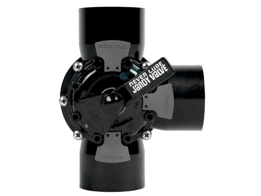

you are 100% right sir : I gets confused with the 3-way Vs 2-way so I'm going to use the term 3 port and 2 port from now on. I have 3 of the 3 port valves : Here is the exact same valve i have :
but mine is old style off course
