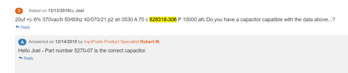

Vid never posted. Was able to get to the one capacitor under the “hump.” The other one has a rusted bolt I gotta figure how to get off.
Cant read the specs on capacitor anyone have idea what I should order to replace
