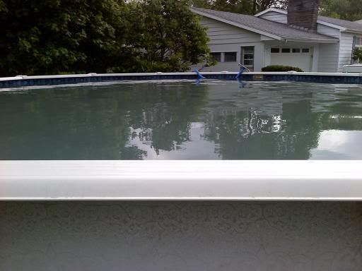

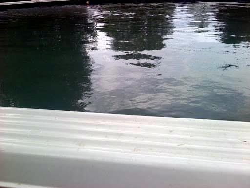

Sorry - I can't seem to get a better photo because of the time of day, plus I'm using a cell phone. The white film is almost completely gone. I just have murk and his friend dark cloud, though the cloud subsides after a bit. Th first pic makes it look like there is a foam on the top of the water, but the wind was blowing and it's actually ripples.

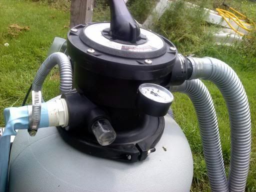

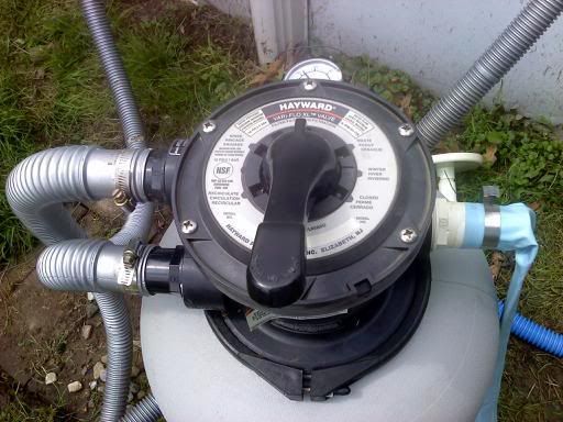

okay - I can't find an air release valve. The tank has a diagram on the side of it, and nothing with a name like that is listed. When I went out, the basket had popped again - I shut off, reset and restarted, and then started looking for the valve again. While I was there, the basket floated up again. GAH! I've now shut the pump down completely, because I don't want it breaking.
Help! Where is this valve? I took 3 pictures - hopefully this will be of assistance.

I believe the air release is actually just the handle. Push the handle down.

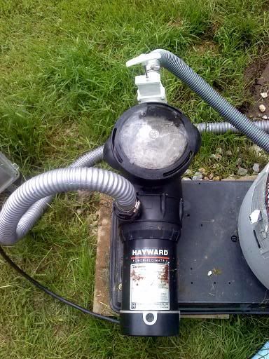

Jesse, if you look back on the first page, I have a pic of the setup before I started having problems. That white thing was always up. It says "gate valve" on it. I *think* it controls the water coming from the pump into the return. Maybe not though. I am not very mechanically inclined.
With the pump off, turn the multiport valve to the waste and wait for water to flow out the backwash hose (light blue hose), then set the handle back to filter. Most of the should have purged.
Ahh, ok. It should be open then during normal operation.
Have you checked to see if the the pump basket is clean?
Yeah, the basket is fine, except that it keeps floating after a minute or so after I turn on the pump.

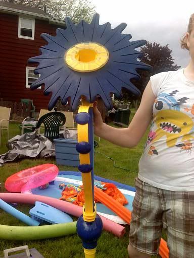

Oh, and what the heck is THIS? We found it in the shed. It looks like some sort of vacuum attachment.

You actually have 2 baskets. One is in the skimmer and the other is in the pump. I was talking about the one in the pump.
You are definitely supposed to leave both baskets in place for vacuuming and everything else for that matter. If you ever actually vacuumed anything up without the skimmer basket in place, it ended up in the pump basket. So you were saved by the 2nd basket in the pump housing. You will need to clean this out.
With the pump turned off, push down the handle on the the gate valve to close it. Open the view port cover and pull out the basket. Give the basket a good hosing and make sure any stringy things are removed from the holes in the basket. Before you put the basket back in the pump, open the gate valve slightly to flush out the pump housing and line. When the water laying in the pump looks free of debris push the basket back down into the hole. When the housing is full of water, replace the view port. Be sure to put your skimmer basket back and then turn on the pump.
