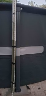

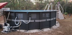

We have a new Intex 18' x 52": Problem Migrating pool legs and now 2nd go at it with same problem. After the 1st fill pool legs started moving in an outward direction. All foundation block ( 2-1/8" x 7 1/2"x 16" concrete) were rechecked using a water level. Tolerance was 1/8" in elevation difference to a set benchmark. Thinking of using a steel cable with turnbuckle to restrict cable from expanding. Need ideas on how to keep cable from climbing up the steel legs. Also seems some type of UV resistant hard rubber or hard plastic, etc to protect the legs from cable abrasion is in order.

Some pics of the pool setup would be helpful .

Yes, the pavers are on compacted and/ or undisturbed clay with some very minor % of sand.
Concrete paver tops we believe to be very near level with same elevation as the pool sand bottom.
This sand was placed on carefully leveled and compacted clay bottom.
A layer of weed barrier was placed on top of the 1st 1.5 " of sand. Another 1" or so of sand was placed on top of the weed barrier and gain leveled.
All concrete pavers were very carefully leveled and positioned with a level to each leg to the mid point of each paver. During pool filling (both times) each leg was checked and adjusted a minimum of 4 -5 times for vertical, until to much water pressure was to great to adjust.
On the 2nd filling after only 3/4 filling, the next day we noticed many of the legs had migrated in and outward direction. We decided to drain the pool again until a solution is found. Some of the legs had little to no migration.
Level of water is within 1/8" - 1/4" over the entire length of the pool.
The clay under the pavers was very firmly compacted and in some cases was undisturbed. Each paver in turn was level front to back and side to side within 1/16" tolerance.

Like i said the legs being a little touch out of level from front to back is ok - so long as left to right is level as well as the the pool as a whole. Your pavers are very close to the pool liner so u may wish to scoot them out a little bit for the legs in question so they remain in the center of the paver. Until the pool is completely full the legs will move - just keep adjusting. It looks good 👍🏻 The only thing I don’t see is an actual level on the legs - although i’m sure u have done that.
@jseyfert3 what do u think?
The pool is expected to move outwards as it fills.
If anything I'd say the pavers would've been better a little further out, but if it was mine I'd ignore it as use it as is. It looks good.
Pools aren't that picky, especially Intex ones. Most I see are installed on hills without pavers leaning to one side and they seem to hold up some how. I've seen some where the water is literally a foot deeper on one side.
I have this same pool and the legs move out when filled. It's the nature of the pool. The legs also move over time with the movement of the water, people swimming in it etc. My pool is set up on grass (I didn't consult anyone before set up haha) and it's still standing (2 seasons).

A big thank you to all for your guidance & sharing! You have eased our worries. :)
Since we drained the pool a 2nd time, now beginning to move the pavers 1.5"- 2" further out from center of pool. Will add and compact some clayey fill in the little void behind each, add sand on top and refill the pool, rechecking and adjusting each leg as before (5-6+ times each) with a torpedo level to keep legs vertical till adjustment becomes too difficult.
