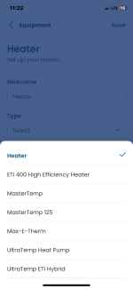

Also attached are pictures of my heater and my choices on the app. I’m not sure which to choose
Ok I FINALLY GOT IT
the pump is on in auto mode
On the app I had to choose booster pump
That is not really correct but got it to work.
To the IntelliConnect your pump is a Single Speed pump and not RS485.
Why is that? If I have a variable speed pump
The IntelliConnect version you have does not support RS-485 control with the Superflow pump and you do not have The RS-485 comm link wired to the left hand RS-485 connector in your IntelliConnect.
We can work on that once you get everything else setup.
Your heater was not wired to your IntelliConnect. Neither was VS control of your pump.
Look at the lower left and you see the RS-485 connector has no wires attached and neitehr does the heater connector.
