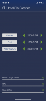

Thanks for the times. Any advice on RPMs appreciated as well. They set our system up for the cleaner to be a feature. Here’s what they look like for speeds (attached). We have a vacuum(?). A little 2 wheeled white guy i think it says The Pool Cleaner or something like that on it. I’m not well versed in cleaners. Is this a suction side??
I was wanting to clear surface debris and get some water moving midday since we’ve had a lot of dust, pollens, etc. Seems to help the appearance of the surface with the extra hour thrown in.
Thanks, Dana
Thanks, Dana

On the surface, I think the speeds are ok. If you do not have a heater, then you could drop your pool speed to 1200, I'd leave the cleaner speed set at 2800.
