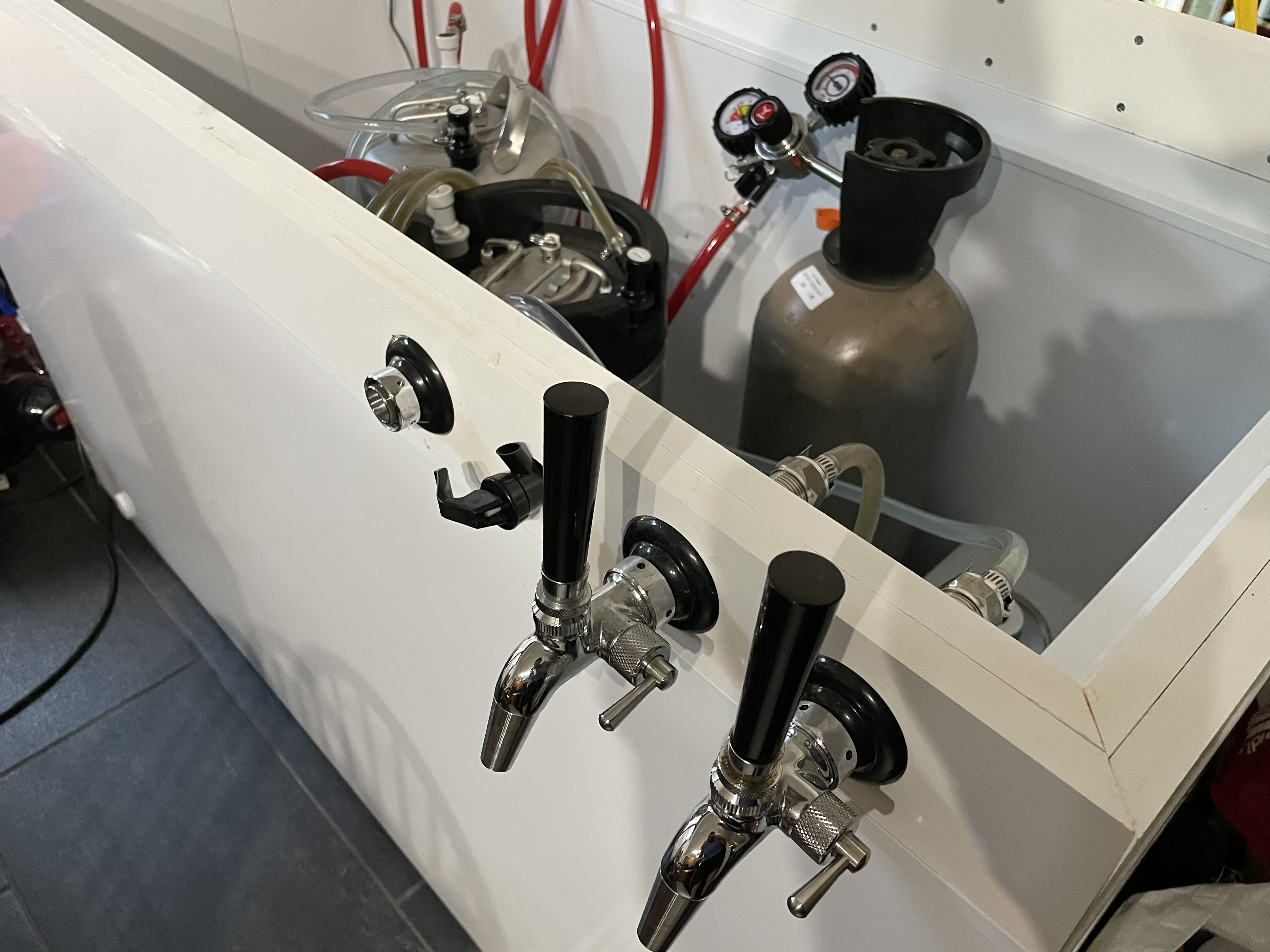

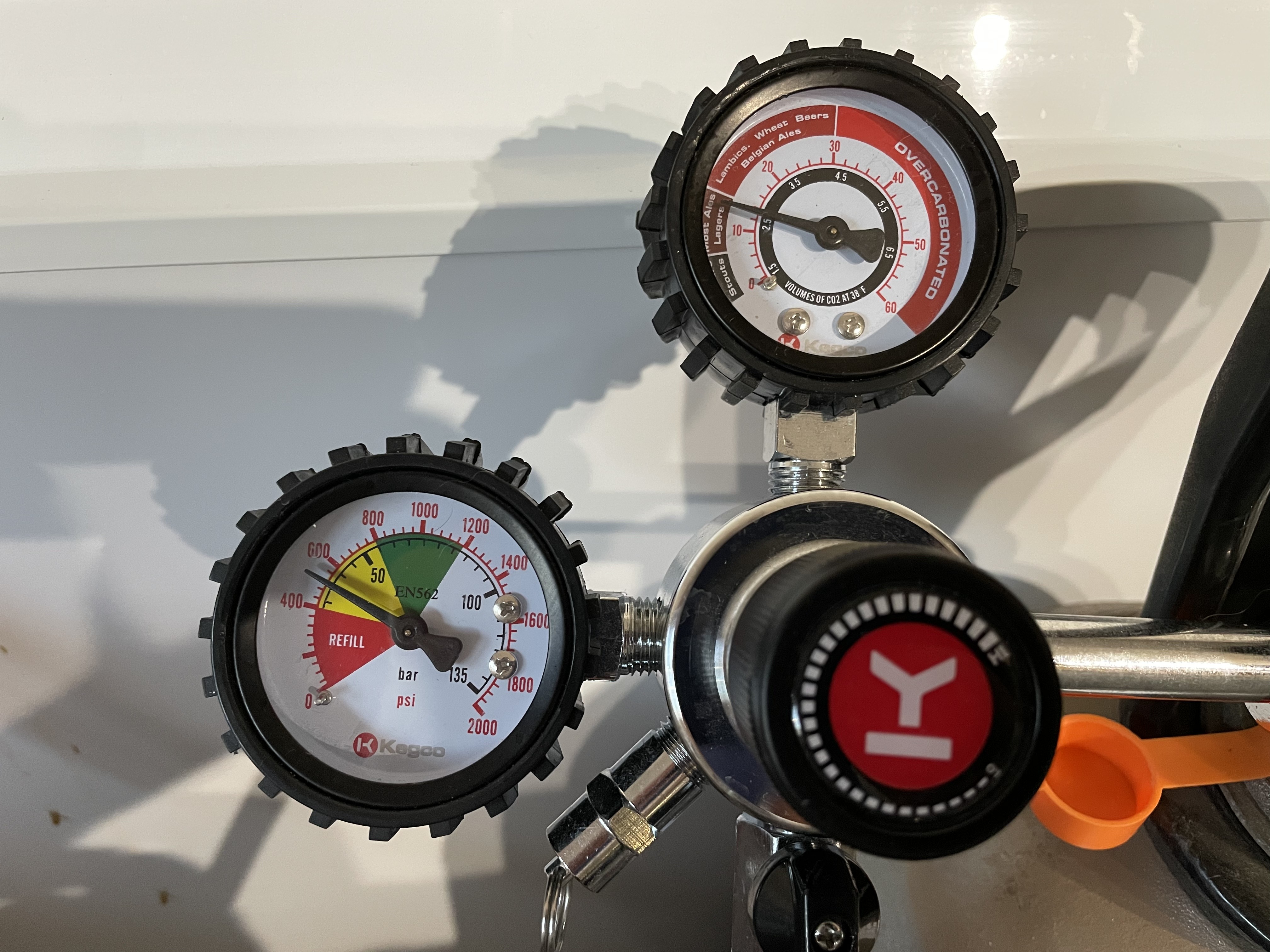

This sounds like your pressure gauge isn’t reading right. At room temps tanks that have liquid CO2 are about 850 psi. They don’t reach 500 psi until they are just above freezing. Outdoors, higher than room temp, the pressure would be even more than 850 psi. https://www.agas.com/media/2426/r744-pt-chart.pdf
For example, the gauge on the CO2 regulator of my preferred type of CO2 injection, that of homemade beer, the tank for which lives inside my homemade kegerator at approximately 39 °F.
Before it lived inside, at room temp it was 850-900 or so, and on hot days it was definitely on the higher side of that.
An offset doesn’t matter much, since the pressure only varies by temp until the liquid is exhausted, at which point it starts dropping and the tank is nearly empty. The offset explains why you continued getting flow for a few days after your gauge read zero though.

CO2 is crazy non-linear over temperature. It is just a bizarre gas to work with-- it can be completely stable at the triple point-- literally at all three phases (not plasma, obviously) at once. So, yeah a high pressure gauge on a tank is really only a good indication if you still have liquid at the bottom. You can't really read anything else into it. I'd almost be nervous about leaving a tank out in the sun here in Tucson.. but the tanks are rated for that....
And honestly.. doing CO2 for beer for several years in both Cedar Rapids, IA and Tucson, AZ, by far the consistently best place to get CO2 isn't from a welding gas company-- it's from the fire extinguisher companies... even if it's a dollar or two more for a 20# tank refill the service is 100x better from the fire extinguisher companies. 2/2 in two places versus 0/2 with "airgas"....
For beer my 10# tank lasts me about 3 years... I guess I don't drink much... but next time I'll have to spring for a hydrotest.... so yeah.. the tank expires before I get the second refill....
I like that Kegco low pressure gauge... It actually lists "lambics"! :)
