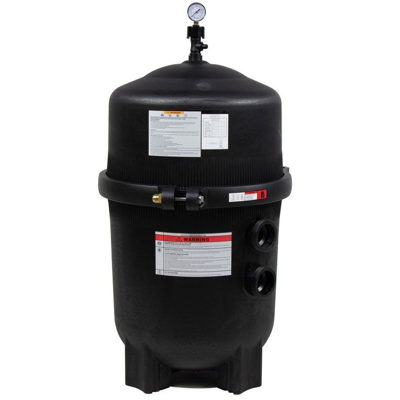

2. You think my choice for filter is alright? I can't determine what size I would need to go with though for this size pool. Also what size pump to go with it?
Get the biggest you can get your hands on! The bigger it is the less you have to clean it!

Filters/pumps: Any particular brands to stay away from? Recommended Vendor to purchase from? Doheney's, Leslie's, poolsupply.com, etc.
That's a 2 part loaded question with no wrong answers.
You can replace the discount brands twice as often (or more) and still break even.
We prefer known retailers as there is tons of stress involved in the current shortage era. Inyopools, recsupply, and polytech pools are 3 others along with the ones you listed. These days you may have to take a chance on a little guy if the big ones don't have what you're looking for.
I am a biased pentair guy and a biased cartridge guy. Most folks like what they were given originally and are lifers. There are a million happy owners out there with the other brands and cartridge types. (Each)
See what is in stock and share it here. Right now THAT is more important than anything!
OH and you NEED good valves like pentair that can be rebuilt instead of the ball valves. You will also want unions on both sides of every piece of equipment to aid in the working on said equipment.
I keep joking to folks that if they don't like the equipment that's available right now, they will be thrilled to replace it when it dies early in 7 years. If it lasts 18 years, they will be buying the same thing again next time.
Makes sense. If I have a 37,500 gallon pool. Doing the math I researched, I should need a pump capable of 78 gpm, so that the entire pool gets filtered in 8 hours. A turnover is the full gallon amount of my pool that will run through the pump and filter in a particular period of time, so I understand. Im looking at filters and the gpm and filter rates can be very similar on a 100 sq ft vs a 525 sq ft filtration area . How does the square footage of the pool play a role in filter and pump selection? I put some links below that describe what I am seeing. Very similar flow rate and turnover time. Just sq ft is way different.
I am building my second 35k gallon pool with a 500sq ft cartridge and a 3 HP Variable Speed pump.
The difference between filter sizes is the frequency you'll have to clean the filter. 100 Sq ft will need cleaning 5X as much as a 500 Sq ft. That's it. The same goes for sand and DE based on their capacities
The 3HP may be too big for what appears to me to be 1.5 inch plumbing, but the variable speed means you turn it down to whatever HP you do need. The larger VS pump moves the same water with less energy and they literally help pay for themselves.
Big,
That is just a load of Bull Feathers.. :mrgreen:
The idea that you have to "turnover" x amount of water per day to prevent algae is just a big myth. It is just not at all true. Chemicals keep your water clear and algae free, not the number of times your pool water passes through the filter. By the time your filter starts seeing algae, it is too late, you have already lost the algae war.
Your filter is there to capture the junk that falls into your pool and floats.
About the pump. I am a big fan of large VS pumps. I am a Pentair kind of guy and the Pentair 3 HP IntelliFlo VS pump is known as the "Gold Standard" of pool pumps. It is the pump that I normally recommend. Unfortunately, they are very hard to find lately due to the logistical issues that have effected the normal supply chain.
If you plan to get a Pentair automation system, then you need a Pentair pump.
If you do not plan to get an automation system, then any VS pump should work for you.
The basic rules is that the larger the pump, the more water it will move at a lower RPM. The slower you can run the pump, the less it costs. It is impossible to go too big with a VS pump or a Filter..
I run my IntelliFlo, 24/7, at about 1200 RPM most of the time, for less than $20 bucks a month.
