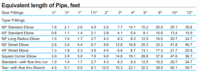

I've found this table : https://media.wattswater.com/Orion-HP-FrictionLoss.pdf
so I think replacing the two 90° long radius elbows (2") with two 90° street elbows (1 1/2") also has an impact
