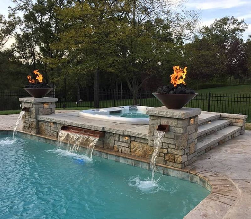

Here is a photo of a drop in stand alone tub built next to a pool - I have seen other similar installs...
I think the best idea would be to build a 3 sided raised wall that the hot tub could be sitting in - so that it is easy to service or remove as needed - that wall could have a spill over like the picture above and it would look built-in.

santacruzpool: dead on! I won't rehash Jim's post, or similar comments he and I have made previously regarding standalone vs in-pool. If I was to build from scratch, it would look a lot like one of the pic's santacruzpool found for you. It's a no brainer: you get all the perks of a stand alone (which are MANY) and the aesthetics of an In-pool. The faux waterfalls are a nice touch, too. Why would anyone want to sit on a flat, uncomfortable concrete bench surrounded by six or eight jets (total) when they could have the true spa experience of multiple unique stations, contoured seats and loungers, on nice smooth fiberglass, with multiple jets (each)?

My preference would be a three sided area that allows full access to the 4th side of the tub - this would work in an elevated design like some of the photos I posted.
The drop in tub would be less desirable due to the issue of getting to the inside of the tub, and the corresponding issues with drainage and other problems that a three sided setup would solve. Having deck access to a drop in tub would be OK, but being able to move the tub in and out easily from the back side, and being able to get at the control panel and plumbing, would in my mind be the preferred option. If someone wanted a truly flush system then that would be harder to service, install, and access the internal parts.
