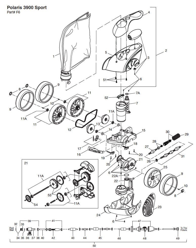

My screen keeps blowing out the side. The original lasted about a year and the replacement OEM part lasted about 6 months. The screen just splits down the side. I've looked in the reviews at the replacements on Amazon and several people are having the same problem.
Does anyone have a solution for this?

It's part #42. My pool was installed about 18 months ago, the original and the replacement both split in the same manner. The result is I get a little bit of debris in the water management system and the polaris stops going to the bottom.
